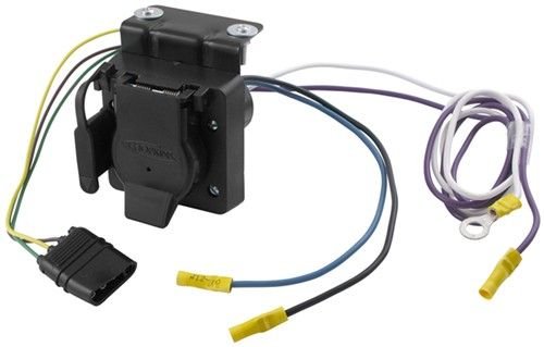

Originally Posted by Phrogger
Another success story here! Thanks for the awesome instructions on how to do this! I saved a ton of money. I did this on a 2014 F150 XLT with no tow package. Here are some pics of where I spliced into the harness under the hood above the driver's side wheel well. My truck had the TBC plug right behind the coin tray in the dash, it was found plugged into it. I took it to a dealer after all the install was complete and now it works like a charm! Gives readouts and information right on my gage display next to spedometer.
So did you run these 2 wires back to a after market 4 pin to 7 pin plug like this one? If so which wire went to which one?
Old May 13, 2016 | 09:01 PM
Snowboard3r411's Avatar
Joined: May 2016
I would assume blue went to blue and your red went to black???
