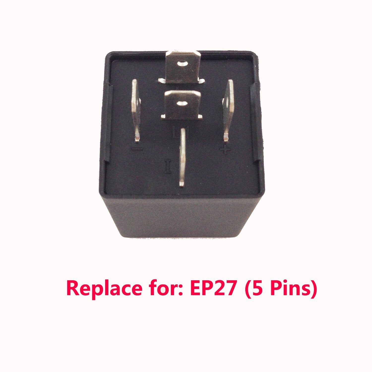

Pick up a Tridon EP-27 flasher from AutoZone for $13. It's located behind the left center of the instrument panel in a block with the blower motor relay.

I'm having this same issue. Can someone post a picture of this mysterious flasher relay? I have a suspicion of where it's located but i'm tired of fooling with it and looking like an idiot with hyper flashing LED lights.

Old Oct 25, 2014 | 08:48 PM
