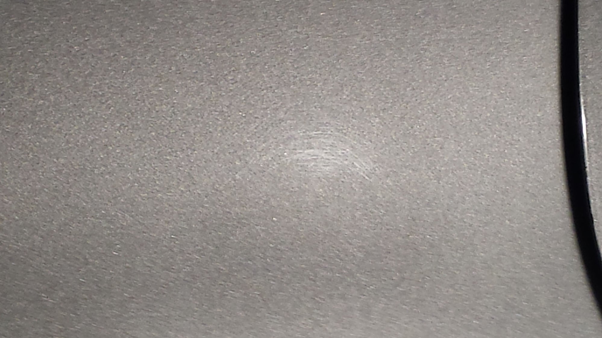

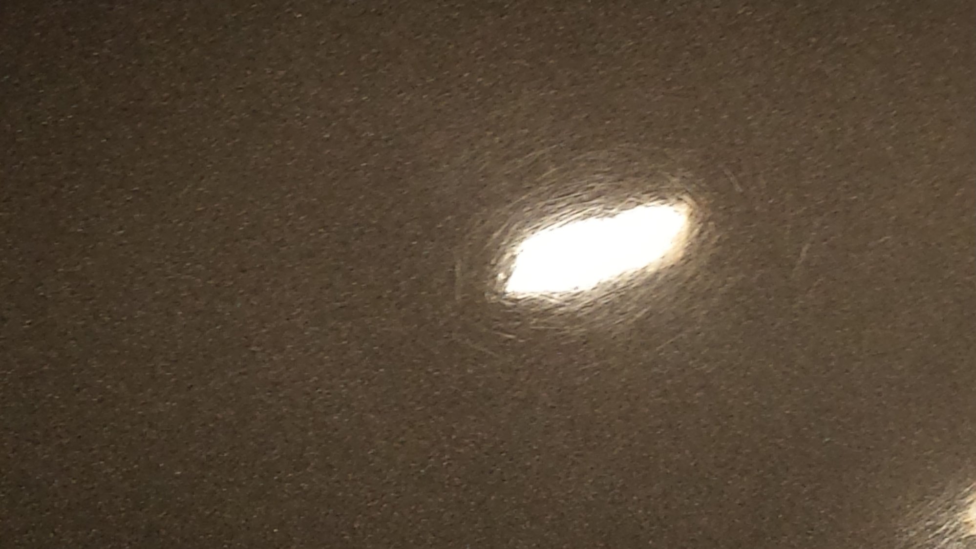

Started a long over due work on the wife's 2001 Expedition. I need some advise on getting out the swirls.
It seems I can make the swirls shine but not go away.
I'm just a little scared to go overboard with the polisher. Any advise will help.
Thanks, Jim

My first post is a little open ended and lacking info.....Here it is.
Products:
Meg's white clay
Meg's QD for clay lube
Meg's Ultimate compound (ran out of 105)
Meg's 205
Meg's Ultimate polish
Meg's Carnuba liquid on the panel that is "done"
Groits 6"D/A
Meg's Maroon Pad (coarse)-with ultimate compound
Auto Geek Orange pad-with 205
No name Black finishing pad 1 for Ultimate polish & 1 to apply wax
Process: Wash-Clay-Maroon pad & UC-Orange pad & 205-Black pad &UP-Black pad & carnuba-Micro fiber towel wipe off.
I'm thinking that the DAT (Ultimate Compound and Polish) isn't my best friend. Any thoughts?
Thanks Jim

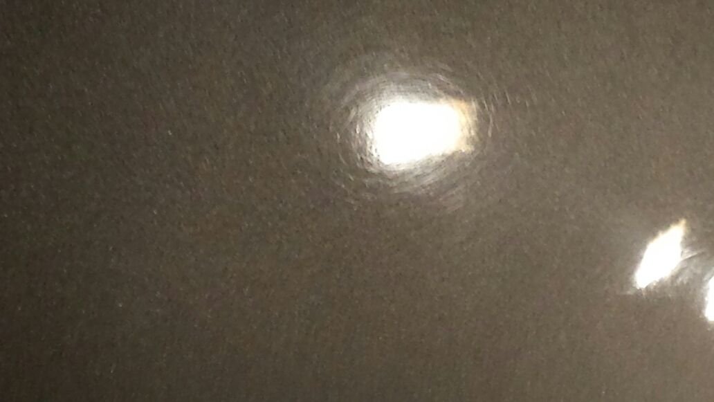

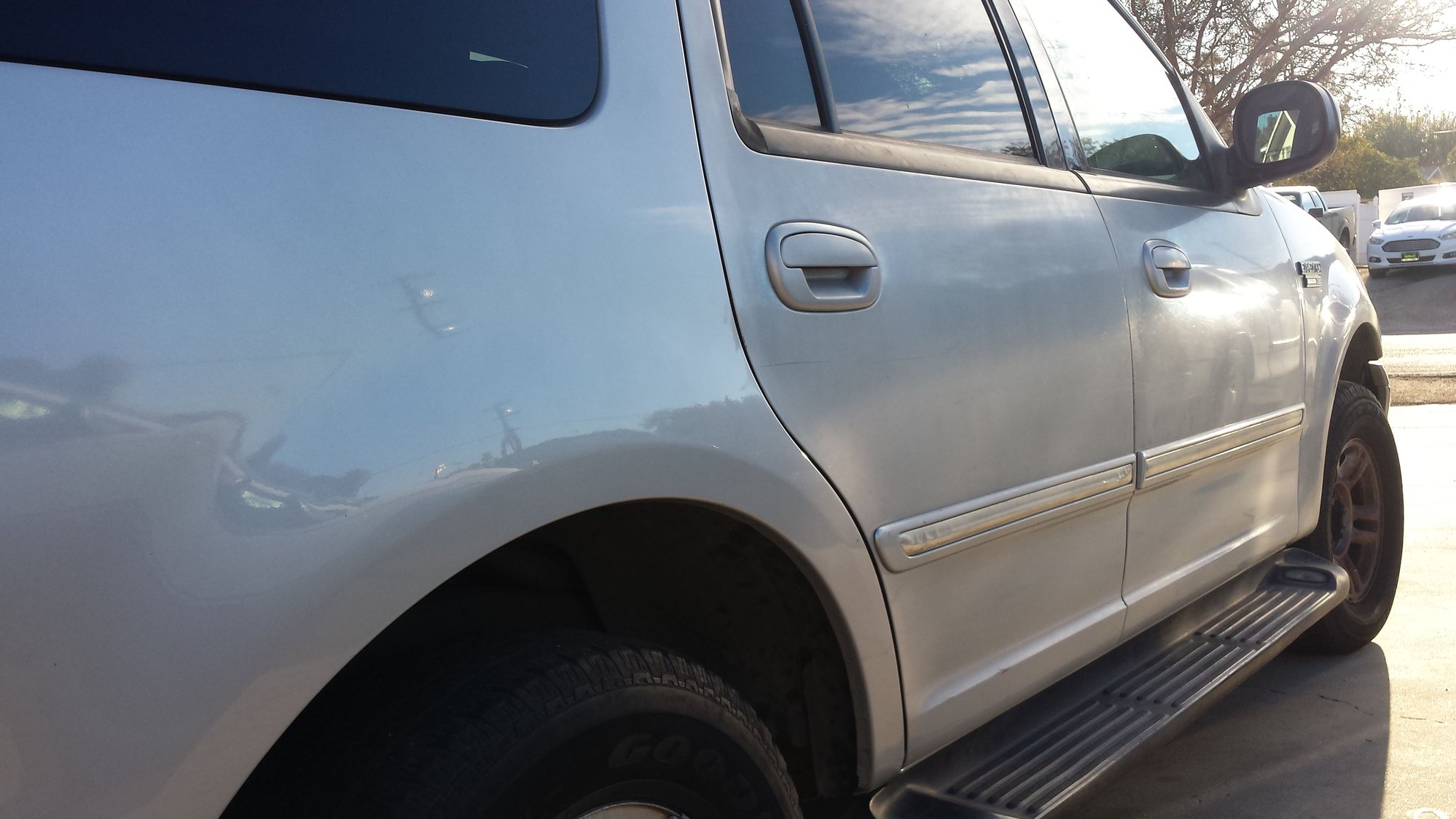

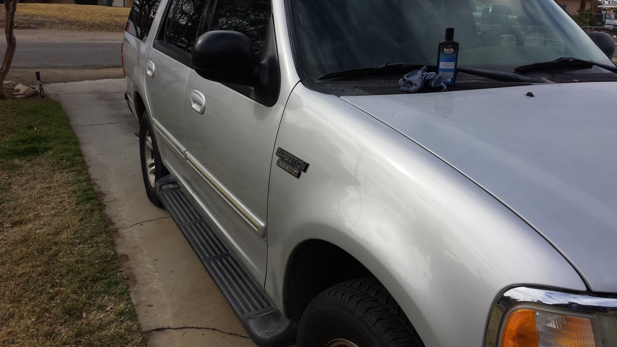

I think I got it. Orange lake county ccs pad and Meg's 205. Set the buffer on 3-4 medium pressure until it started to drag, then gave it a squirt with the water bottle and light pressure for about 4 more passes. I'm happy, what do you think......not too bad for a 16 year old paint job.
I'm no Merlin, but I'm getting better.

Looks pretty darn good, but I'd recommend Meguire's M101 with that same orange pad. You'll be amazed how much quicker it will correct. Then you can follow up with the M205 on a white CCS pad, then the LSP of your choice.
BTW, try some Poor Boys Spray & Rinse Wheel Cleaner on those front wheels!

HUGE Improvement! Nice work!
I might suggest a Megs DBP5 5" backing plate, Megs 5" DMC5 discs and some Capro Essence.
Run the GG at about speed 3-4 not faster than five and use arm speed at about 1" per second.
Essence is a mild finishing polish (it contains some CP Reflect finishing polish in the formula).
I have found the 5" Megs mf discs and CP Essence to be a swirl killer/Outstanding GLOSS combo!
Again...Nice Job!
