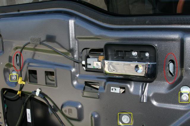

1. Manually push the window up all the way and tape to hold the window in place. I used 2 inch painters tape.

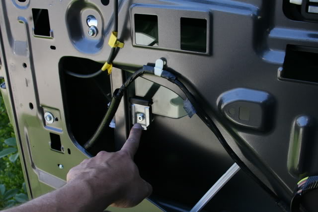

Here is a picture of the clamp (one on each side holding the window to the tracks via T30 Torx bolt, before I manually pushed the window up.
2. There are two vertical slots (hightlighted red) where you can use a T30 Torx bit to loosen the two clamps that attach the window to the tracks. Then you can pull down the loosened left side clamp and both will lower/release from the glass window (held in place with the painters tape). Use caution to loosen and pull down so the window doesn't also follow. Then there are 5 bolts (four at each end of the two tracks, and one that holds the window motor/regulator (3 highlighted in yellow, other two lower out of pic frame).

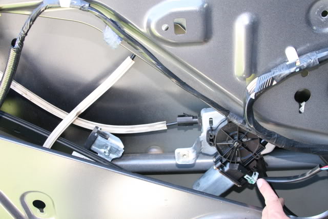

3. After you unbolted the two window clamps and 5 bolts holding the assembly in place, you can collapse the assembly through the opening. Easy to maneuver, I took the right side out first then the left side, just dont forget to unplug one wiring connector to the window motor/regulator, its easier to unplug at the outer wiring harness, here i pointed to the actual window motor/regulator connection.
