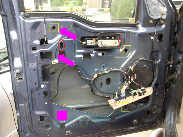

Here's my door:
Most of the mounting/access holes in my door are the same as Brazen's, ecept for the upper left one. Ignore the purple square at the bottom left, it's the same as other trucks. Note the two purple arrows up top. One shows where MY regulator mount attaches, the other is an approximate location where the replacement part should attach.
Are there any Ford techs on here that can help me with a different part number (other than 4L3Z-1823201)? I have an early 2004 new body style 4-door (Super Crew?) Lariat.
I suppose that I could drill through the door panel and mount the new regulator if there is not another option. But then, I'd need some help with the exact location for the hole for proper window operation. On second thought, there's a different indent in Brazen's door panel that I would need to mimic with spacers, etc........Arrrrgh!
