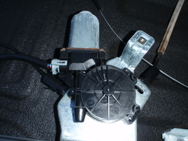

Is it the plastic clip, where the cable goes into the motor, that broke? I've thought about taking all my doors apart and trying to wrap the clips with tape to give it a little more support, but don't want to waste the time if it's different parts that are failing.

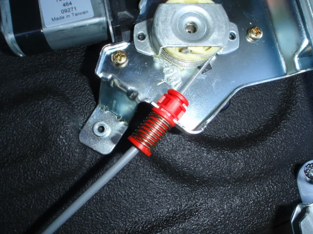

My regulator wasn't broke at the plastic connector, but the actual cable was broken just above a "ferrel", I suppose you'd call it. Here's a pic:

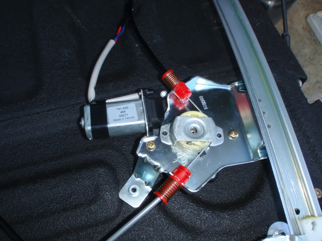

The plastic connectors on the motor are reinforced substantially on this new unit. They're different connectors as well. Here's pics:

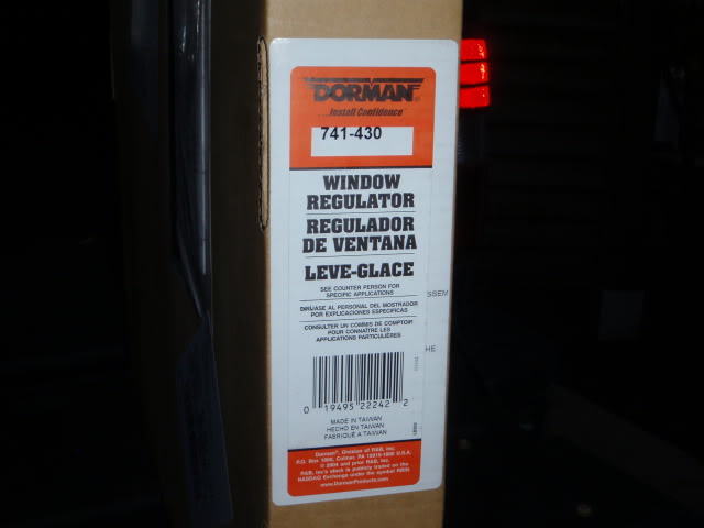

As for the mfg., part #, etc... Here's the box label:

Rolled it down today at lunch, back up, near the top and it "Popped" and down went the window. Took it out and the cable had essentially backlashed on the motor pulley like a cheap baitcaster. It locked the whole unit up and things came apart. The little red "thingies" with the springs were extended instead of compressed like above. Appears to be some sort of safety feature maybe.

I paid more attention to the workings of this thing the second time I installed it. The springs on the red connectors sort of act as a buffer, it seems, to cushion the blow on start/stop. Not a bad idea I think.
