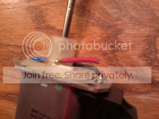

This is what I found, the broken Red wire. This one shows the output shaft with the worm gear on it.
A better shot of the broken wire.
The new wire soldered in and it works again!! I know.... its the wrong color, but its all had.
