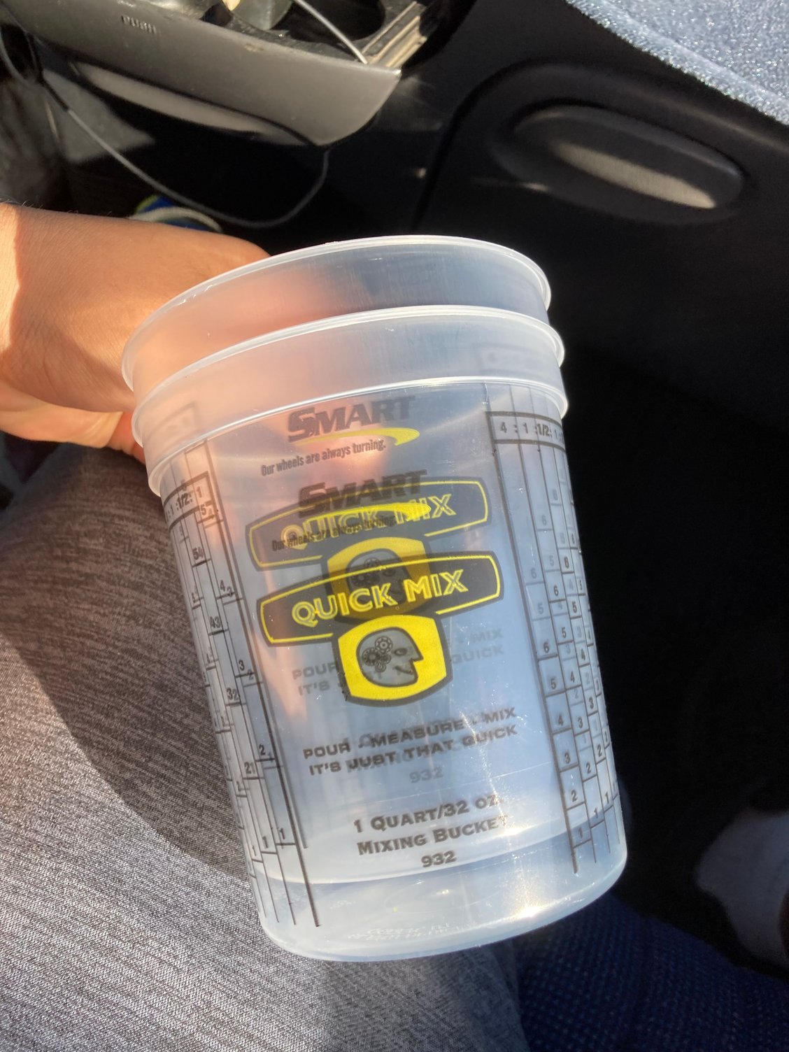

Yeah they actually didn’t sell me any of those useful cups so I went back yesterday and bought a few of ‘em, I initially bought some at Lowes but those only have measurements for ounces and nothing else, very basic. These new cups have everything I need thanks for the suggestion @beechkid
Old Mar 18, 2022 | 06:21 PM
You can do the same with units of measure. It's just some maths involved to get the parts.
But it's easier with what you got. lol
