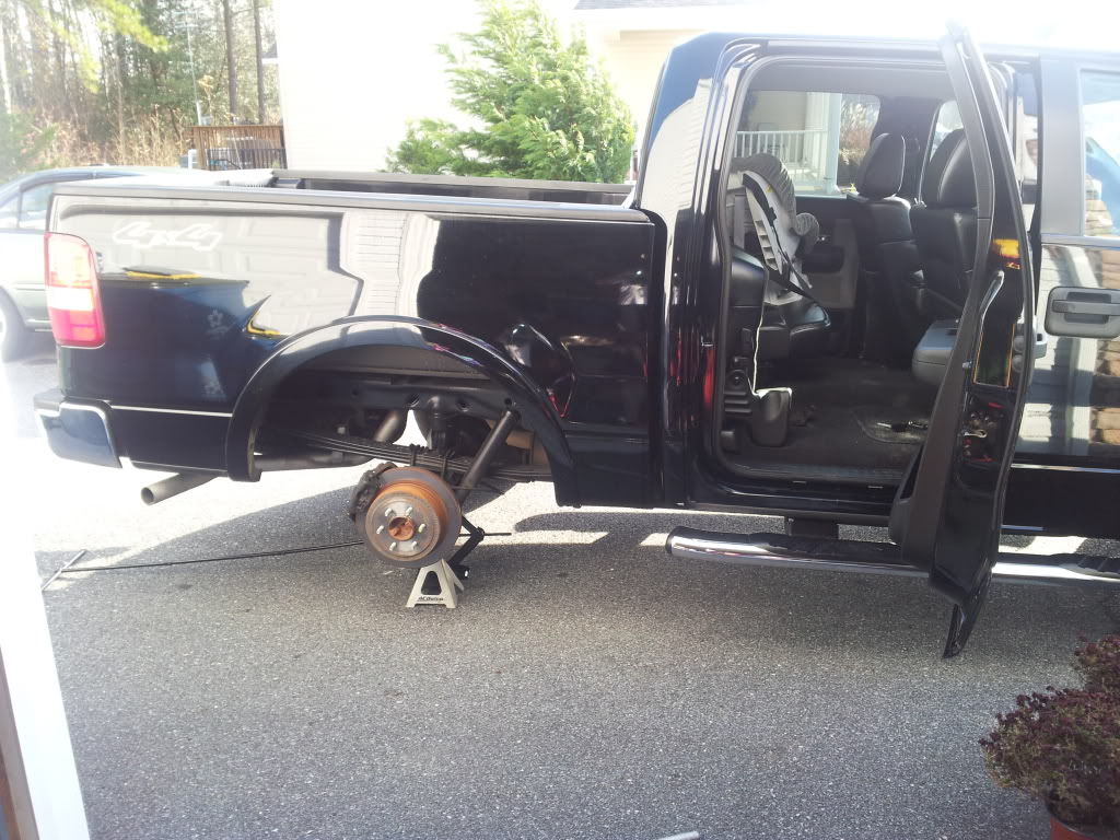

bmackhulrs - I removed the wheels and used index cards around the outside lip of the wheel. You don't have to use index cards, but it's just a cleaner way to do it IMO. I would not spray them while on the truck. You don't want it getting on your brakes. Taking your time is important. 3 to 4 coats allowing it to dry at least for 20-30 minutes in between coats. Make sure you have plenty of day light......

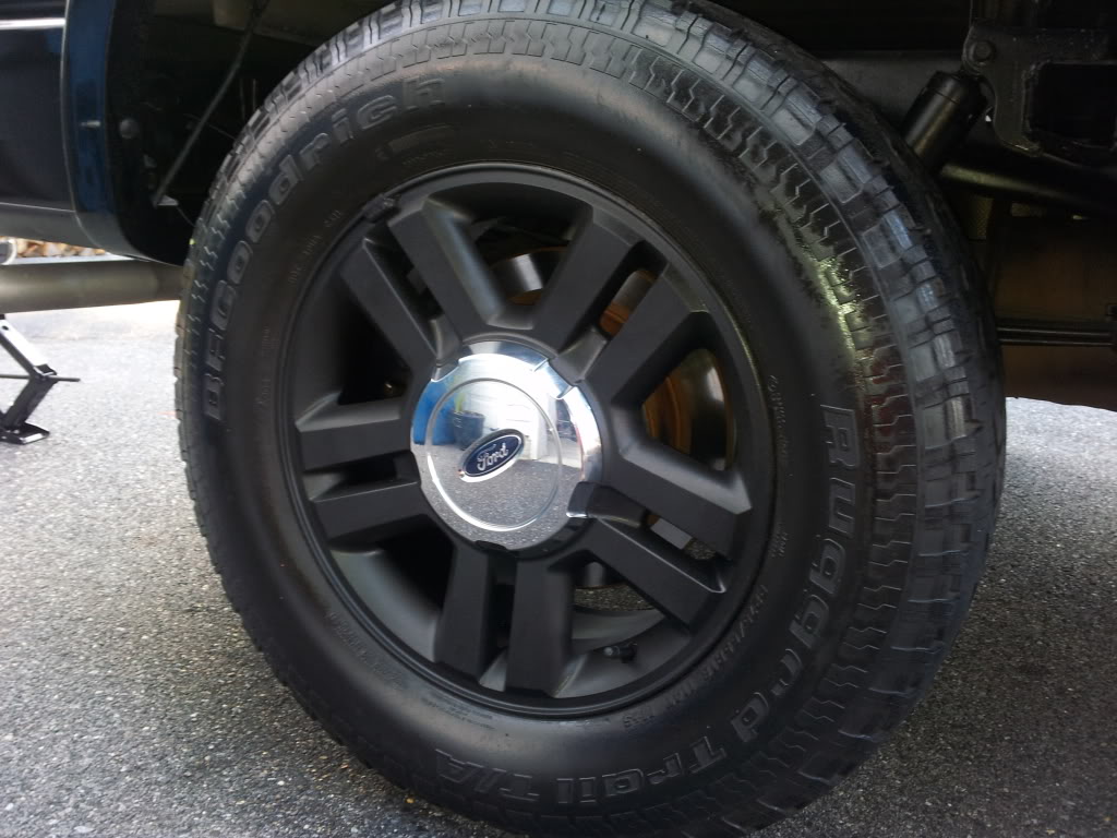

I just Plasti-Dipped mine this past weekend. I loved how they turned out..
I was wondering though...is there a Clear Coat or Something I can put on to shine them up a bit and protect them??

PD makes a "glossifier" that you can add to the wheels that is like a clear coat. You can spray normal clear on it too, but the dip won't peel off as well. It still comes off fine, but it's brittle and chips rather than peels.
