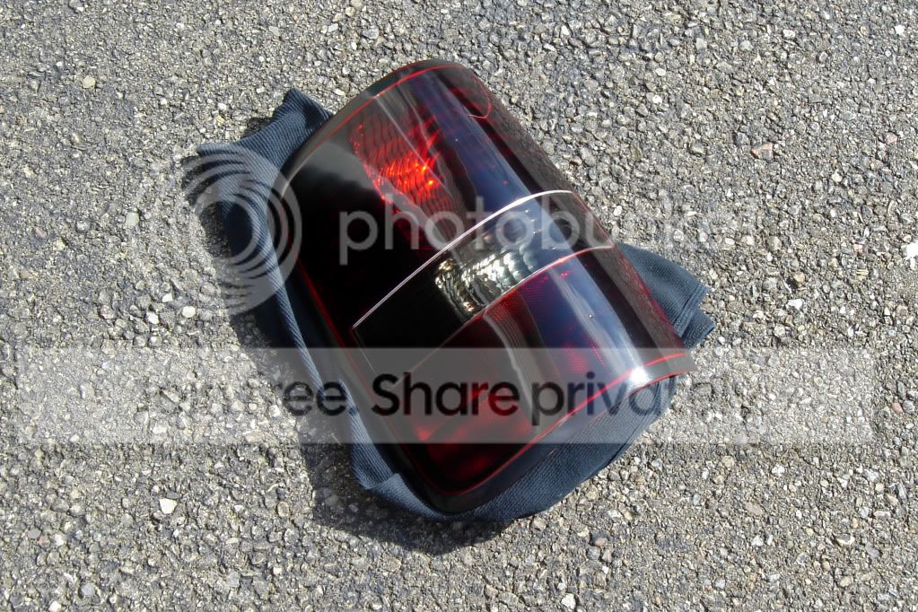

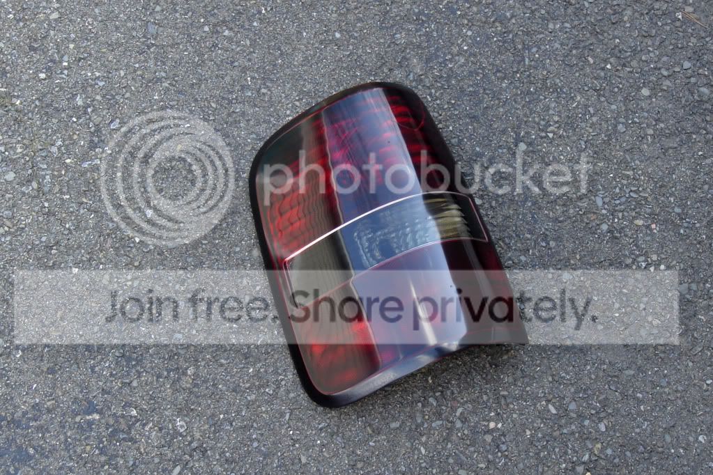

What Darren said
BEFORE.....
AFTER.....

Yep, thats my next plan. I had a project tail light so I smoked it and worked with numerous clear coats and darkness levels. One of the last things I did was opened it up and painted the reverse section, and didn't to the rest, but I put a black shirt in it for one shot. Its definitely one of my plans to come real shortly.
