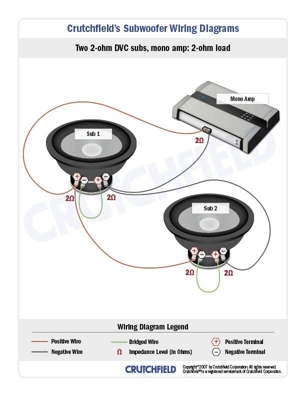

I have a JVC headunit set at max gain and an Alpine MRP450 mono amp gain maxed. I have freq cut off set low like 100 htz and no bass boost.
The amp is rated 450 @ 2ohm and subs are 250 rms. So each sub should be getting 225 rms. They are Rockford Fosgate p2 R2D2 2ohm DVC. One coil goes to amp and other coil the positive goes to negative. This should be a 2 ohm load.
Is this correct?
Do I need a bigger amp?
Maybe bad ground?
Will it hurt subs if I get a 1ohm amp?
Maybe the ****ty aluminum 4 ga wire with several splices?

I noticed I Have mine wired right from coil to amp on both speakers, not coil to other coil then only one set of wires going back. Maybe this makes a difference?

Looks like this more so...
