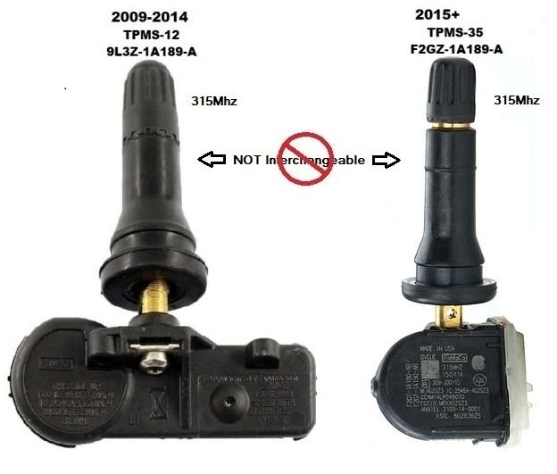

If the 2013 20" rims are FoMoCo, all of the spec's will allow seamless tranference.
The only gotcha will be the TPMS sensors. *The gen'12s (2009-2014) are not compatible with the gen'13s (2015+).
Also... The lug nuts will be sunk-in slightly more due to the difference in the hub mount plate. NBD (NoBigDeal) and only cosmetic. *The threads of the gen'12 lug nuts are not compatible with the gen'13s'.
