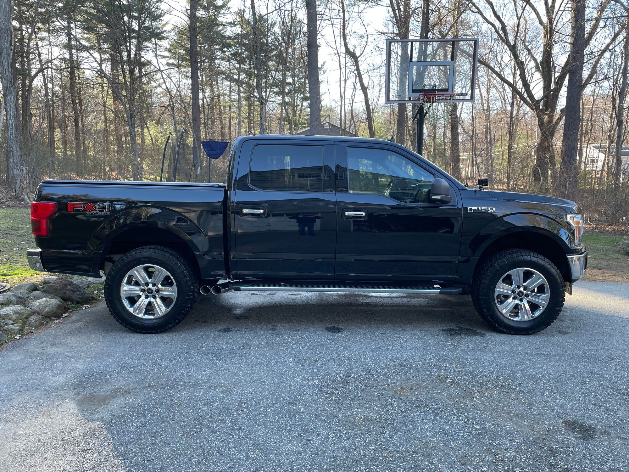

brand new here to the forum. I bought my ‘18 two years leftover in Feb 2020. I have about 48k and my coyote consumes a lot of oil. A qt every 1k to 1.5k miles. Have been using Amsoil since new. Has anyone local to Massachusetts gotten their engine covered under warranty?​​​​​​​
