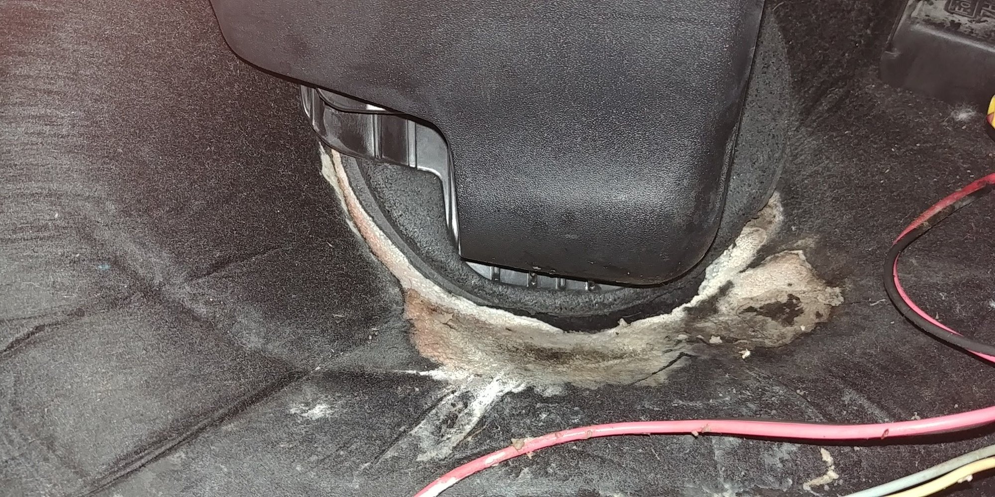

Took floor matt out few days ago to clean and noticed a lot water under matt. Pulled back matt and based on the white area in photo it's been leaking for quite a while. Dried matt and sanitized with vinegar solution to kill any mold spores.

Before cleaning - buildup around the condensate drain area.
