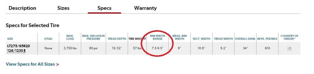

Old Jan 30, 2021 | 10:34 AM
Posts: 43,542
Likes: 819
A 275/65R20 can be used on rims from 7.5" to 9.5" wide. Reference:
