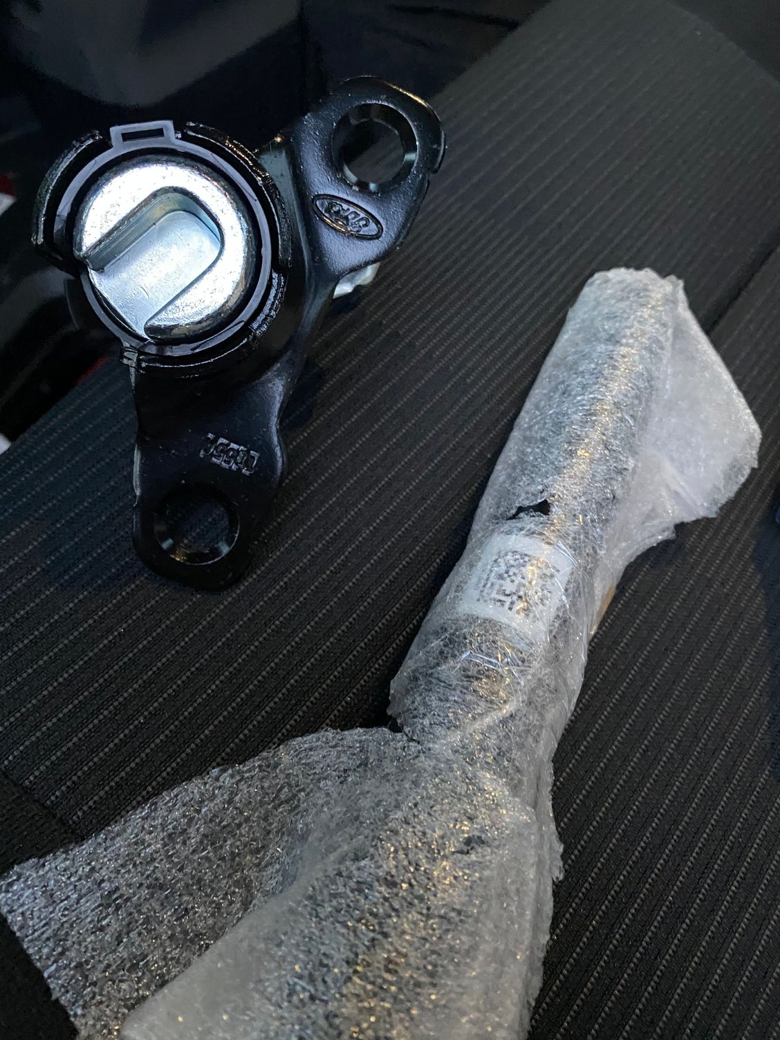

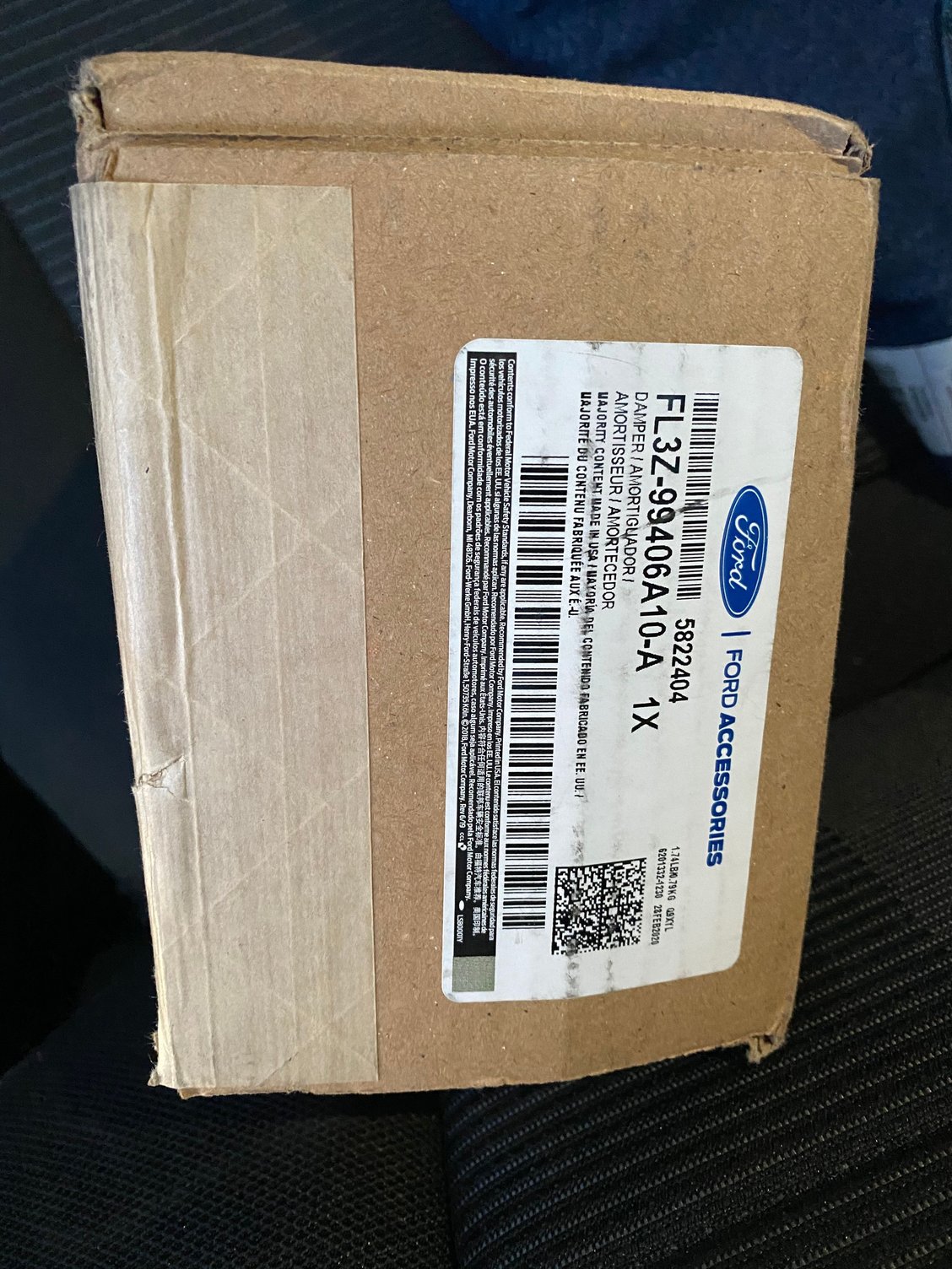

Here’s the correct part number
Here’s what my roller looked like
Shot of my roller and shock
