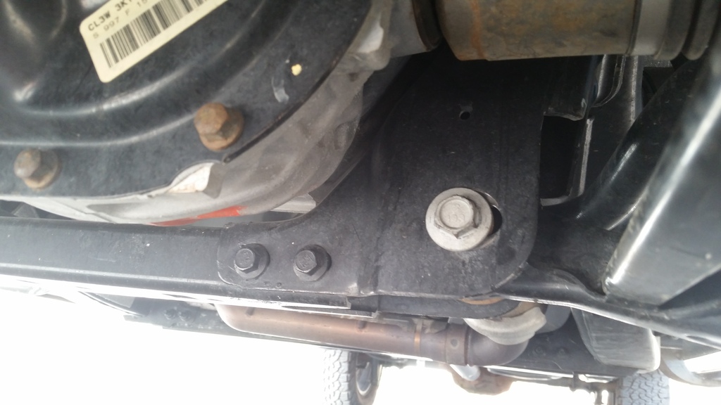

So today while I was checking over the front end, I noticed that the driver's side lower control arm bolt has obviously moved from its stock location. If you are look in at it from the front you can tell the hole is elongated, I am assuming for adjustment. I have 1.5" spacers installed, so would have this bolt been adjusted when it was aligned? If any could snap a pic that would be great. Drivers side, lower control arm bolt, viewed from the front. Thanks!

I forgot to specify, the rear side of the control arm, not the front bolt..

They probably moved during the alignment

On the previous generation both the front and rear cross member holes are slotted. This is to adjust the camber for the wheels. The toe in can also be tweaked this way too. It was probably done after the spacers were installed to get it aligned again.
