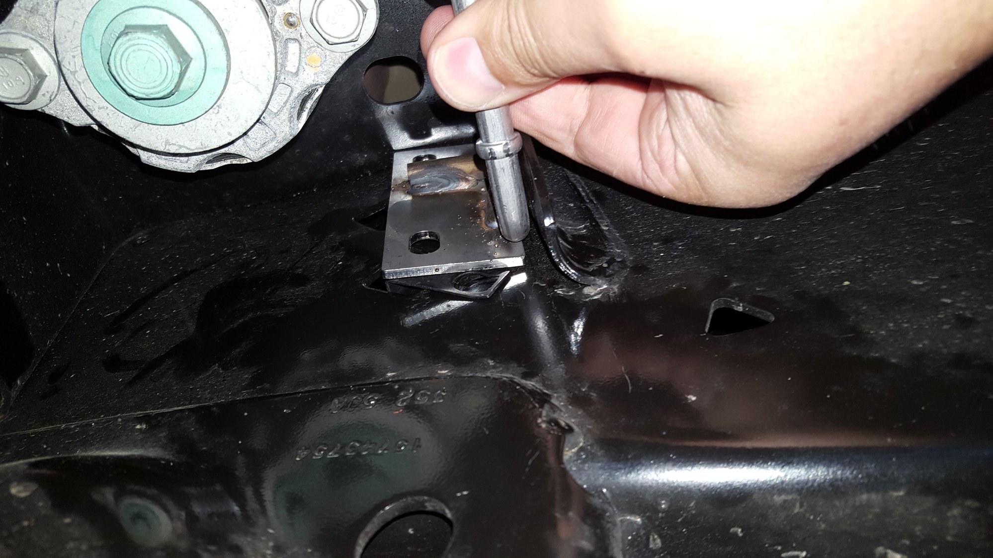

Hey guys, I recently purchased the Magnaflow cat-back side-exit in front of the tire exhaust kit (p/n: 19054) for my 2016 XLT SuperCrew with 5.5' bed. (145" WB) This afternoon I tried installing it. I ran in to a problem when I tried to install the hanger bracket that comes with the kit. The supplied hanger bracket would not fit in the space it needed to go and it didn't line up with the holes in the frame like it is supposed to. Here is a picture of what I'm talking about.

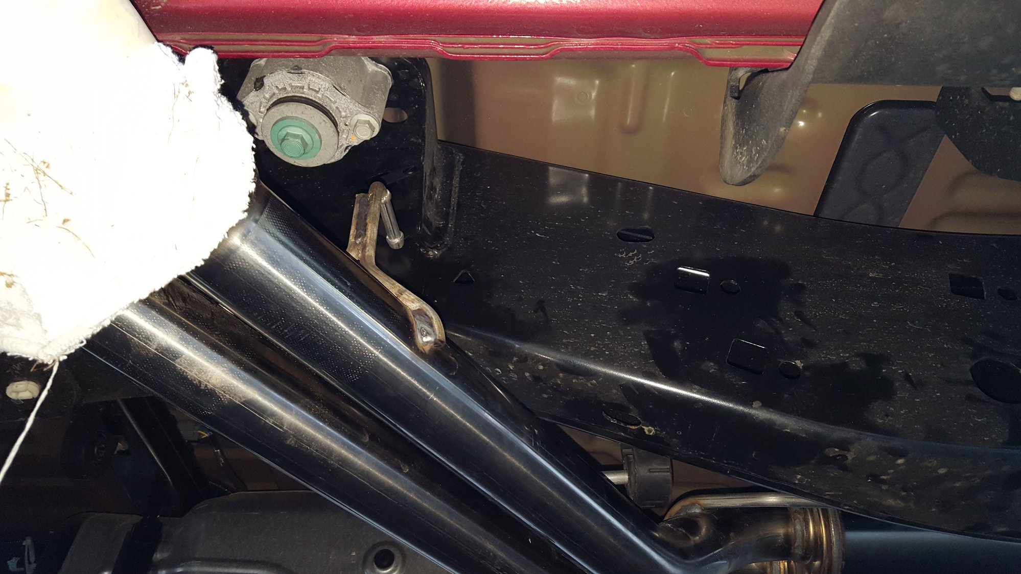

Here is a picture showing the bracket that is welded to the exhaust kit in relation to the frame.
I called Magnaflow technical support and the tech didn't believe me at first. He told me they had sold a 1000 of these kits with no issues. He sent me a picture telling me I was trying to install the bracket in the wrong place. I then Emailed him back saying the location he was referencing was not correct as it would put the exhaust tips in interference with the rear tire by about 6" and the supplied pipe before the new muffler would not reach either at his recommended mounting location. I sent him a bunch more pictures and then I get a call saying he did not know what was going on. His data says they tried this particular kit on the same style truck as mine. He was going to have to talk to their engineers tomorrow because he was dumbfounded.

I may be looking at it wrong but the bracket should not go right in the frame should it? It should hook into some sort of rubber bushing otherwise it would rattle like crazy against the frame.

The picture is actually deceiving. The bracket welded to the pipes doesn't actually touch the frame wall.It's just hard to tell from that angle. The hanger connects with a rubber bushing to the hanger that I'm holding against the frame in the top picture.

OK makes sense. It does look like something is off. Hopefully Magnaflow will correct the problem and replace it with the correct part.
