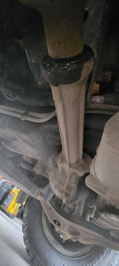

Hey guys, can anyone tell me what the problem is? I have a loud clicking sound coming from the front end. I thought it may be a cv shaft but they look pretty good. I can get the click to stop by engaging 4wheel drive. Any help would be appreciated!

What is this on? Can't see the rest of the truck through the Internet.
Sorry! This is on a 2013 F150 5.0l Supercrew XLT 4x4

The clicking is likely an IWE issue. Read this thread:
https://www.f150online.com/forums/ar...then-some.html
