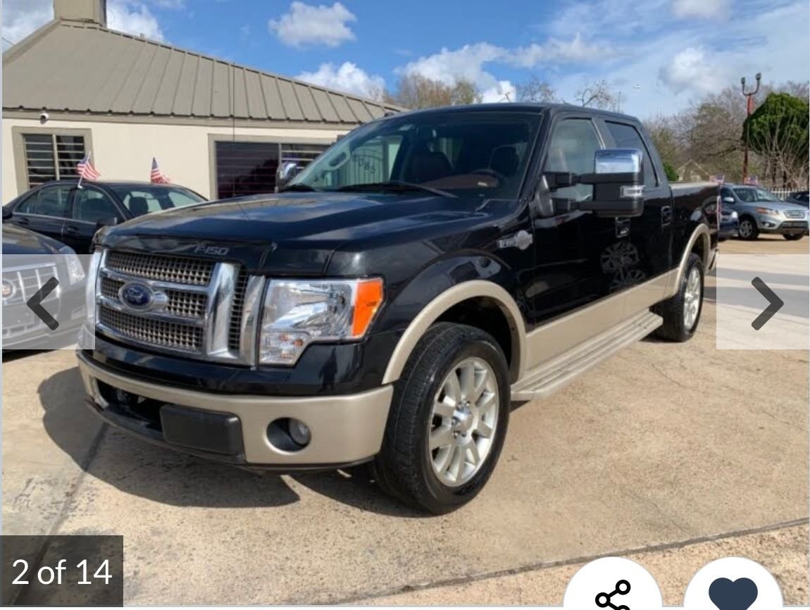

I’ve found a 2010 F-150 King Ranch 4X2
with 110,000 miles on it for $14,400. Truck looks absolutely spotless, but the 5.4L engine scares me. Can I get some opinions on if you believe if this is a good deal, and should I take the chance on the 5.4L engine? Have always heard nightmare stories on them, but from what I have read after 2008 they are pretty decent engines.

Eh, if you can walk them down to $12,500, I'd take it. Being it a 2wd with the 5.4l personally diminishes the value.
Yes, these trucks do come with towing packages. If you plan on towing anything, I highly recommend one -- even a Drawtite.

If the engine is not making any noises, it looks like a good truck to purchase.

$11-$12 thousand is what you really want to spend on it. The 3 Valve motor is meh, but it's not a deal breaker if you can get the price right. Get an independent mechanic to help you check it; have him hook up his scan tool to check for ACTUAL OIL PRESSURE during the test drive. Ford's gauge clusters are NOTORIOUSLY INACCURATE. Oil pressure should be at least 17 psi at IDLE and top out around 25-35 when your foot's in it. If you have 10 psi or lower at ANY point during the inspection or test drive; WALK AWAY. I'm resurrecting/bulletproofing an 04; (first year of the 3-valve) and let me tell you; you do NOT want to EVER have to go through this repair EVER; it SUCKS.
