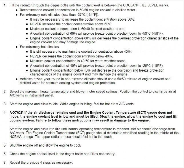

Hey, I found this on another f150 forum. Here. They claim it's an excerpt from the factory service manual. The other recommendations was to let the dealership do the coolant flush as the guy claimed they were only charging $110. Now I'm not going to get into an argument on whether $110 is a fair price, but hey, if you make more money at your job per hour than it takes you to do the service yourself and pay for the materials, it's worth a shot. They might be able to check for any other abnormalities as well. They'll be able to vacuum it out effectively as well unless you have that sort of mechanic equipment at home already.
Hopefully this helps! If not, I'm interested in what others have to say for future reference.
