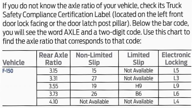

I have owned my 2013 ecoboost for a little over two years now. I bought it used obviously, so there are some modifications and I have no idea what gearing it as, if anyone knows how I can figure that out that would be cool. anyway I average between 11-12 mpg. is that reasonable for this motor? I have buddies that average closer to 16 in town and that's why I bought the eco. I do not have a lead foot and drive pretty conservatively. I have been told that I should get a programmer with custom tunes to "adjust" for mods but the mods aren't that huge in my opinion. I know previous owner added cold air intake, bigger tires, dual exhaust, and it appears to have a small lift or leveling kit, will these mods kill my mileage that drastically or should I be looking for a bigger problem somewhere?
Old Apr 9, 2019 | 11:10 PM
Posts: 43,535
Larger tires and a lift kit will hurt mileage. Intake and exhaust shouldn't make any difference.
How accurate is your speedometer and odometer right now? Compare it to a GPS and/or highway mile markers.
To roughly check the rear ratio, chock the front wheels, jack up the back, put it in neutral. Mark the driveshaft and rear wheels. Get a helper, turn both rear wheels in the same direction exactly one turn. Watch the driveshaft and count the revolutions.

Besides what has already been noted ... Other issues (to name a few) that affect MPG
  • driving habits.
  • use of tow/haul mode.
  • unnecessary weight in the box and/or cabin.
  • tire pressure.
  • fuel - octane and quality.
  • attention to routine maintenance - oil change, air filter, spark plugs, etc..
  • idle time.
  • condition of the front-end suspension components.
  • wheel alignment.
  • contaminated MAF sensor. *ROUSH CAI air filter is oiled.
  • RAR (Rear Axle Ratio).

Great info! thank you gDMJOE for the chart, according to that its a 3.73 electric locking rear end. so it seems the fuel economy im experiencing is to be expected with the mods that have been done on that pickup and there isn't anything wrong with it that ive over looked. its a very well maintained truck the cold air intake is a pain in the *** in my opinion (to keep clean and oiled). So the last question I have than is, would some custom tunes help fuel economy, or at the very least help me get the most of my mods?
