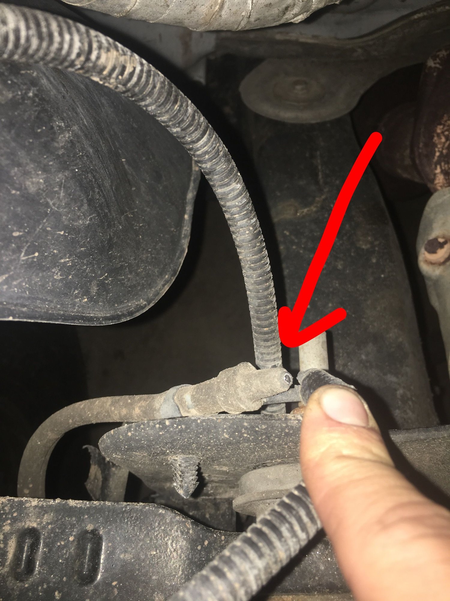

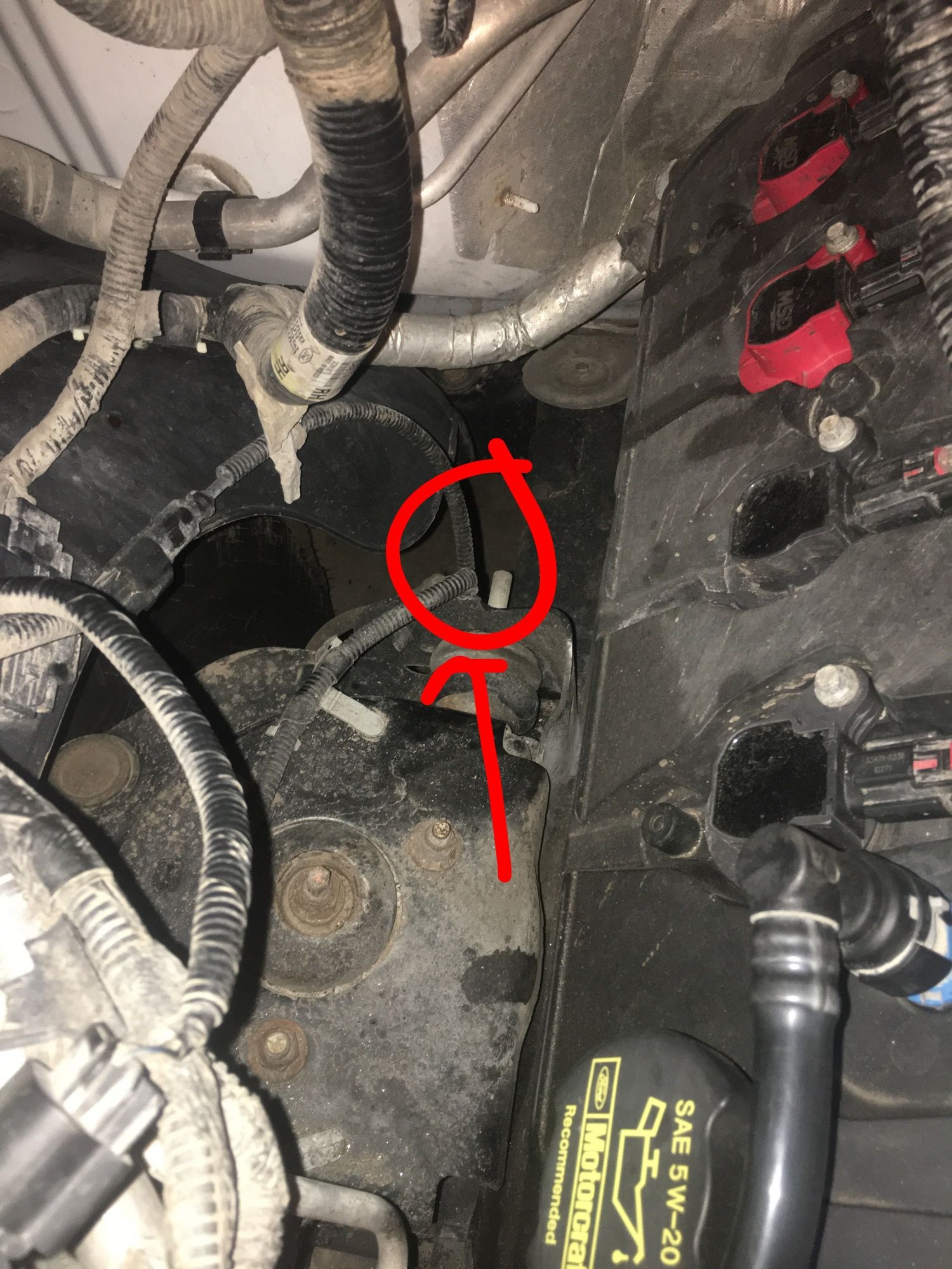

*After finding the broken hose, I used a screw the same size as the hose to screw into the hose and remove the broken piece of tubing from the connector.
Inserted the hose back into the rubber connector and NO MORE SOUND

So I researched the IWE, and still had a gut feeling that they are working fine, but rather I did something hose related to the IWE when I took off the intake manifold.
I believe I found the issue! ***But hopefully you or someone on here can confirm or deny it.
When trying to get a better angle while working on the intake, i stepped inside the engine area and it looks like I pinched this hose on the passenger side (when i put my hand on it to feel, it broke right off so I'm sure it was already cracked:
If someone could also direct me in the next step on how to fix this and how simple/difficult it will be that would be great
*The hose next to it wasn't damaged
