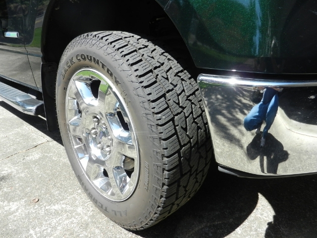

I just spent about $1100 on these tires, but they are still the OEM size, but I really like this style of tire over the stock Bridgestones that came on the truck..
These are "Back Country A/T" from a local tire chain in my area and the stock 275/55/20 size.
