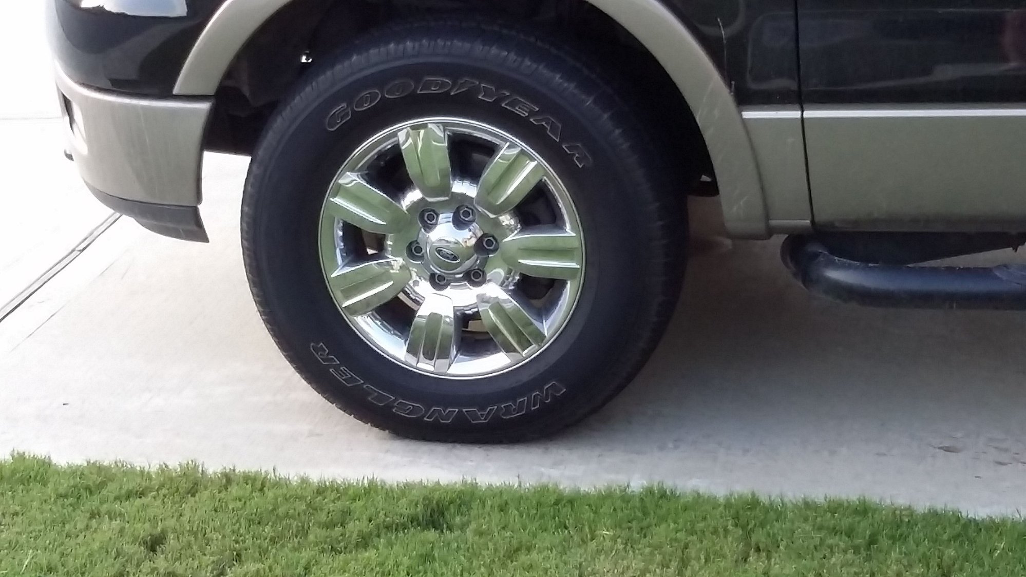

I put on a set of 2013 rims on my 2004 Lariat. Other than the need to swap out the regular lug nuts for chrome ones, everything fit drives great. These were 18" rims, same size as original ones.
