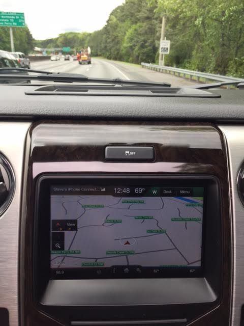

Well this is really weird! I had larger tires put on last Friday and the nav has been screwed up since. It'll sometimes figure out where I am but it's usually several streets off.
This pic shows it well. I'm on the I-285 in Atlanta and the interstate isn't even shown on the nav screen!
I'll try leaving my battery cables off tonight and hopefully that will fix it.

This is crazy. Mine is CPO so I'll take it in soon and see what the dealer says. I'll post what I find out. My outside temp reading is also about 20 degrees off today...
