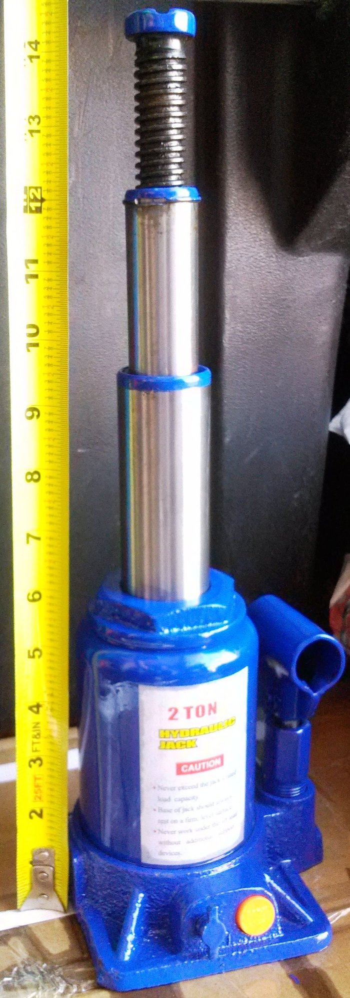

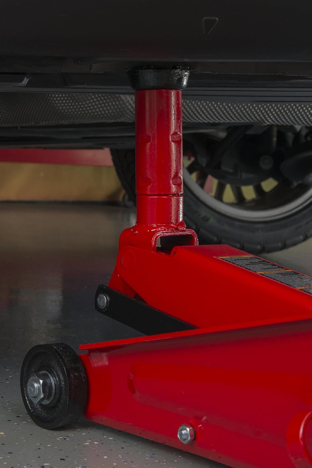

Nest to consider how you will lift the truck. You already have a bottle jack. That's good. It may not be good enough.....or so I have found with a lift kit. Actually, a bottle jack with the ram fully extended, was not able to raise my Transit Connect high enough to get the tire off the ground because the suspension travel was not fully extended. 5" bottle jack piston vs 6" suspension travel. Although that should not be a problem with an F-150 if you are lifting from the lower control arm in the front, and the differential in the rear. A regular bottle jack will not be high enough to reach the rear axle tube. A regular bottle jack will not be good enough to raise your truck from the frame rails.
You may want to look into a double ram bottle jack. I have had success with those on other vehicles.
With a 6" lift, I found that the bottle jacks are good enough to lift under the differential, but the base is very small and I fear that the little bottle jack saddle is too small. I wanted something just a little more stable. A UniJack works pretty well. I also like the Torin SUV/Truck floor jack & Torin Hybrid Jack. You will probably also want appropriately rated jack stands with the proper height extension. A 6" lift put my frame rails at 18" high. A lot less to worry about if your truck isn't lifted.
