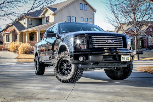

I know a guy who runs 17x9 Fuel Mavericks on his 2011 FX4.

Post
Think Raptor ...
-OR-
-OR-

Originally Posted by gDMJoe
Think Raptor ... -OR- -OR-
