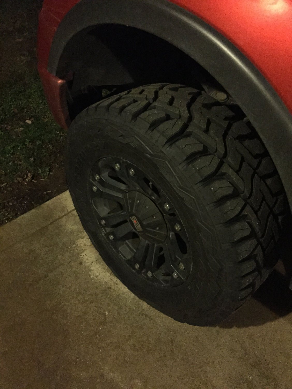

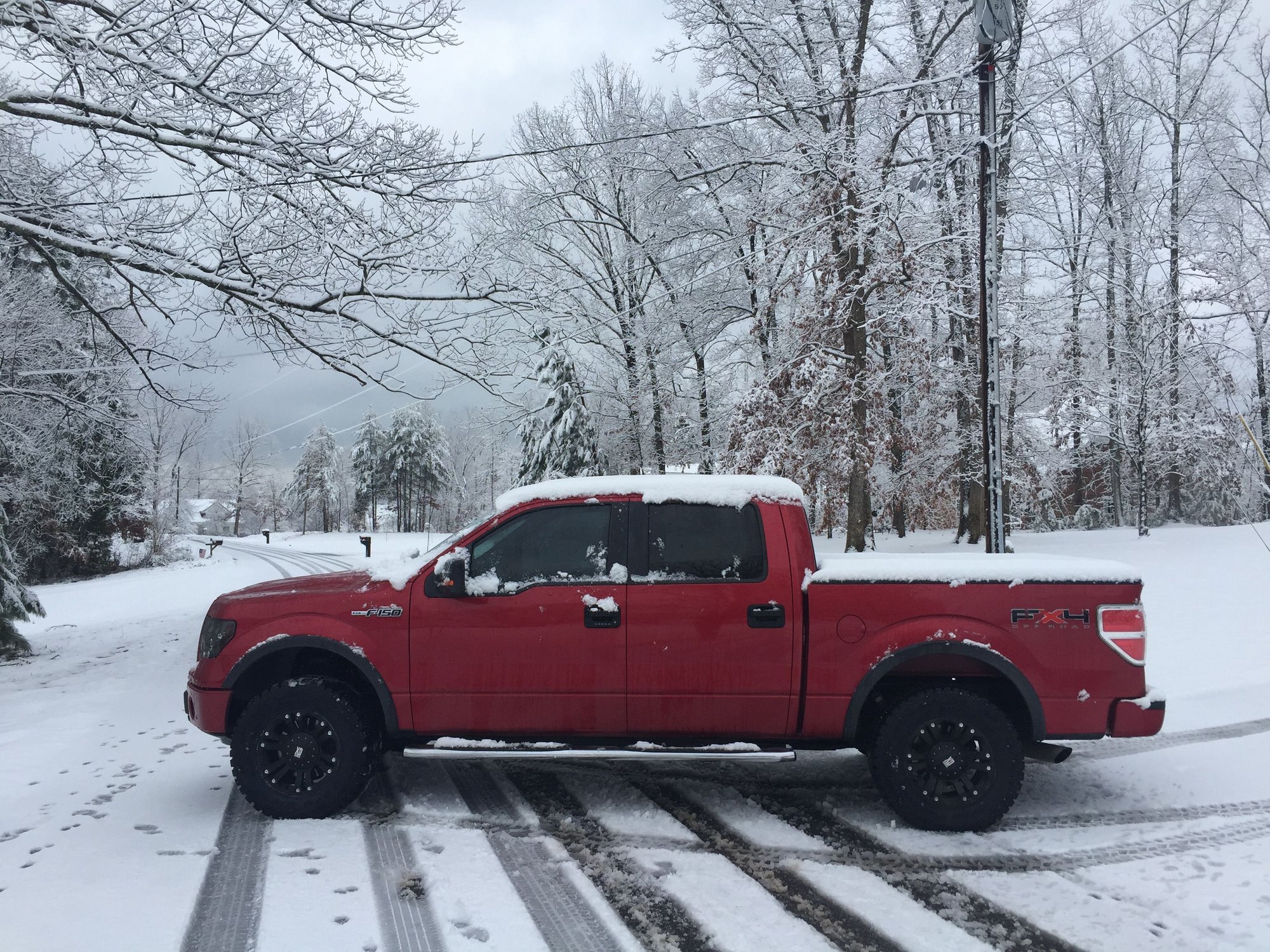

So I got the Bilstein Height Adjustable shocks installed, cranked them to 2" height, and installed 33x12.5x18 Toyo Open Country RT's on there. I love it! Thanks for all the advice.
Question: What psi should I put the Toyo's at? I'm at 40 right now. I do mostly highway travel.
