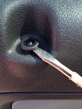

To put back is just the opposite of removal accept keep this in mind the panel that covers the seat belt has two tabs on the bottom that you gotta put into the door panel in the slots and then push the top into the clips
Upon placing the door panel back on the door if you remove these grommets you will do alot cussing trying to get the door lock rod in the hole!
