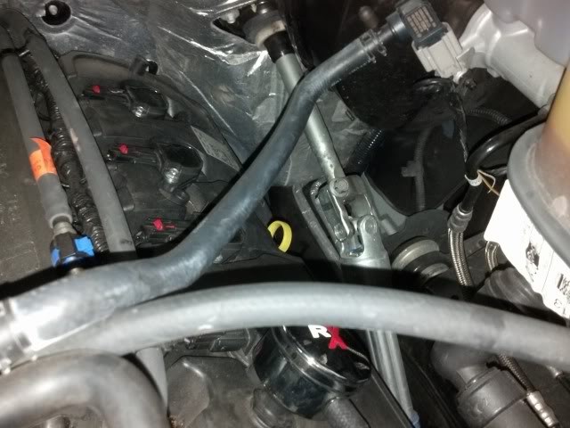

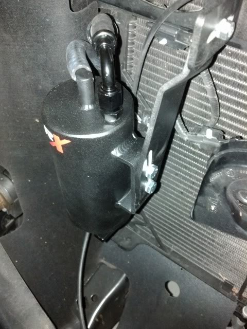

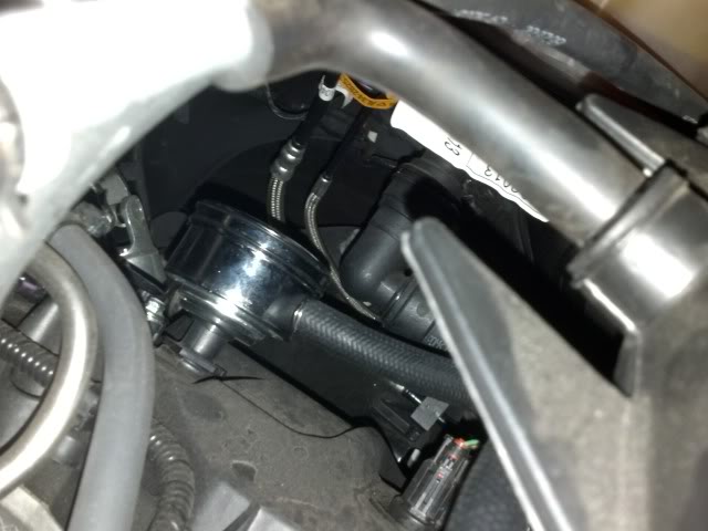

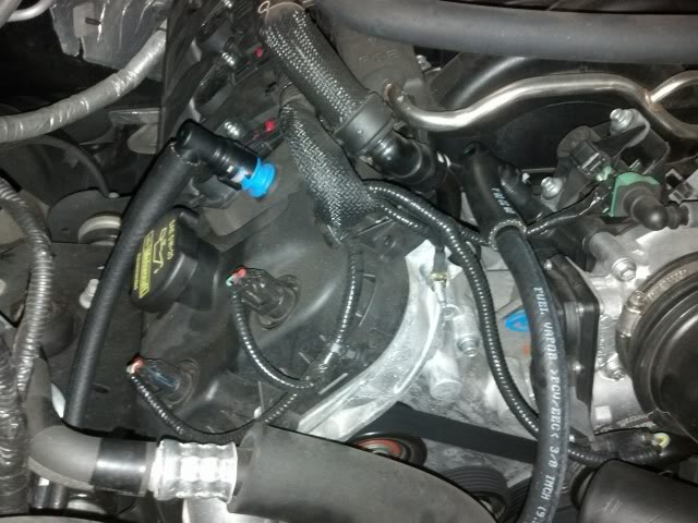

Since I am local and Tracy at RevXtreme.com has been selling these like hotcakes and the 5.0 guys needed a install guide I bought the can and got free install and a free 1LE dry side separator. Which is now going to be in a different spot than the Ecos (seen below). I met Tracy, his shop mate Tony and the shop dog Big Dog! Great guys and great dog. I was given lots of great info and even saw first hand effects of the Direct Injection affects to the engine without a catch can. He had a few engines apart of different vehicles with varying mileage. You could see that the lower mileage cars valves where clean but the surrounding area covered in grime. The higher mileage one was covered. Direct Injection is good for many things but buildup is a major side effect. I broke my engine in hard and it obviously helped eliminate plenty of blow by. If you dont seat the rings properly your in trouble. Hit the high RPMS guys and get it on it in every gear from the beginning. My TB looked very clean as well as the intake tract. I did have oil in the Intake manifold which we cleaned out pretty good and what we couldnt get will eventually work itself out into the catch can.
He has a lot more pics and instructions on F150forum. PM me and I can send you a direct link. I know I cant post that here. But on with my pics. Not many but it gives you an idea. Tracy knows what he is doing. He even has other model catch cans cut in half to show you the faults and went in great depth explaining the differences. It was a great experience. Not to mention his daughter and son in law are champion drag racers and man there are some pretty trophys in the shop. The daughter takes after her dad!
new 1LE location pics

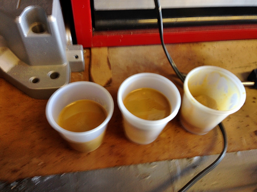

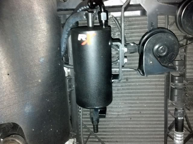

I was collecting about 1-2oz of oil every 1500-2000 miles in the summer. Winter is a different story thanks to short trips (moisture build up).

Shocking amount of oil IMO. This is on NA motors?
MY blown 3v don't pump that much oil, For sure not.

Yep, NA 5.0's. Both the F150 and Mustang version have this issue.
Most of what you see in my last two pics is water, hence the ball of ice floating in there.
