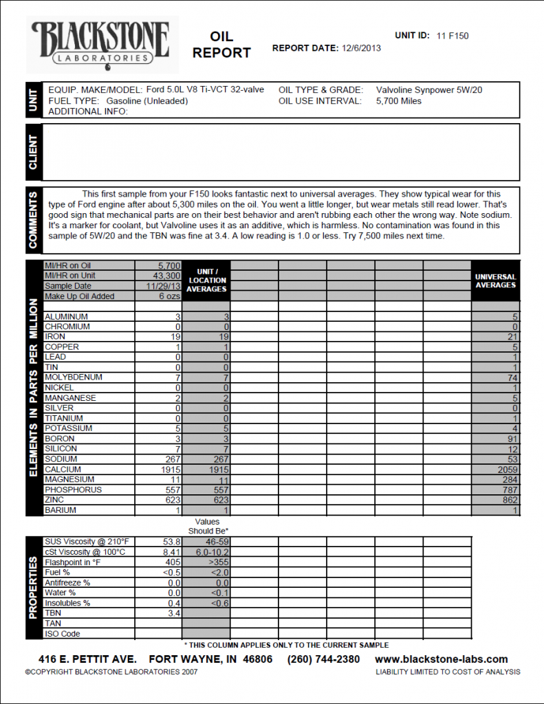

First oil analysis from Blackstone Labs on my 2011 FX4 5.0L. Truck was bought used in May 2013 from CarMax with about 34,700 miles and was bone stock. First oil change was at the end of June with 37,600 miles when I switched it over to Valvoline SynPower 5w20 with a MC oil filter. Also installed a UPR oil catch can at this time as well, and about a week after the oil change 33" Wrangler Duratrac's were installed along with 5star custom tunes. Run the 87p/t tune the majority of the time.
About every 1,500-2,000 miles I collect anywhere from 1-2oz of oil in the catch can. Several weeks ago the oil level had dropped to the bottom of the hash marks on the dipstick so I added about 6-7oz of oil to bring it back up to the top.
So, there was about 5,700 miles on this sample when I changed the oil the weekend after Thanksgiving. Truck had 43,300 miles at the time. It had been in there a little over 5 months. So, here are the results from Blackstone.

Nothing to worry about there.
Old Dec 7, 2013 | 04:34 PM
So your motor likes salt (sodium) with its gasoline?
Looks good though, except you maybe waited a touch too long to change it because of the viscosity levels? Pretty neat test!
I guess...
What makes you say that? Valvoline specs the cSt Viscosity@100*C as being 8.7. Mine was 8.41 after 5700 miles.
Old Dec 7, 2013 | 06:26 PM
I was looking at the SUS being a little too high compared to the "average", which I'm assuming doesn't really matter. And your sodium (salt - sodium chloride) levels were high, but that doesn't matter, just a joke!
Old Dec 8, 2013 | 10:58 PM
Labnerd's Avatar
Joined: Mar 2003
Posts: 2,226
Likes: 42
From: So. Texas
The only thing that grabs my attention is the sodium. Yeah, they have it in the formulation but this is higher than Valvoline specs for this oil. If you get another report I'd be looking for the numbers on the sodium. In better words, I wouldn't worry about it but have a heads up on the next report to be looking for it. The iron at 19 is a hair high but if I read it correctly this was a 7 month run. The iron is not iron as in wear metals but corrosion from sitting. More than likely the valve train. Nothing to worry about. The flash is in line where it should be and the viscosity is where it should be. At this rate per this report, I hope you like this truck cause it's gonna last you a long time.

Alright, thanks Labnerd.
