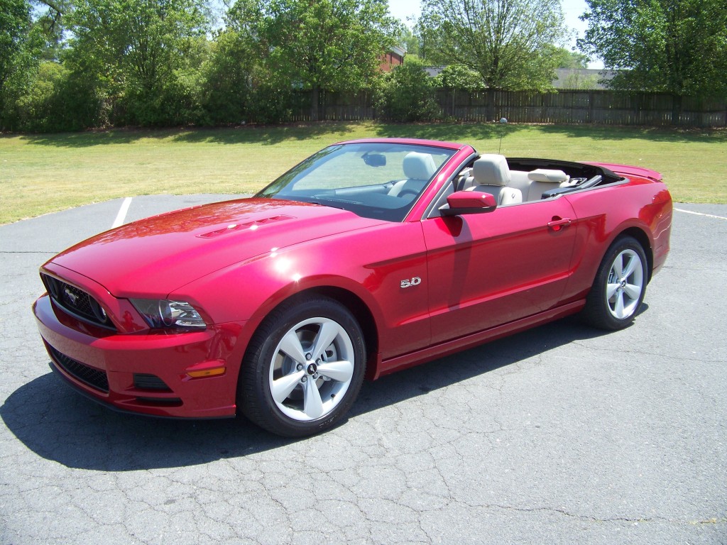

Brother Hotlap, let me help you out here. This is the Wifey's, and what a hoot.
Go ahead, get ya one. You will not regret it.

Wanted, nice looking Mustang, your wife is very lucky!! A few years back I had a 2008 Shelby GT500 and that Stand would scoot as well! Would still like to drive the 5.0 in the new GT though, I hear it is a fantastic engine.

It's a world of difference from her previous 4.6L GT. If you do go drive one, just take your checkbook with you. They are pretty addictive.
