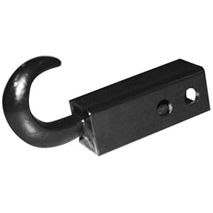

I use this
Same as mine!

Originally Posted by 09supercrew
Same as mine!
It looks hollow, bent them in the past. Only solid receivers are what I will buy now and in the future. Also use them on a receiver on the skid steer plate and tractor mount so the overkill is well needed in some of my aplications.
