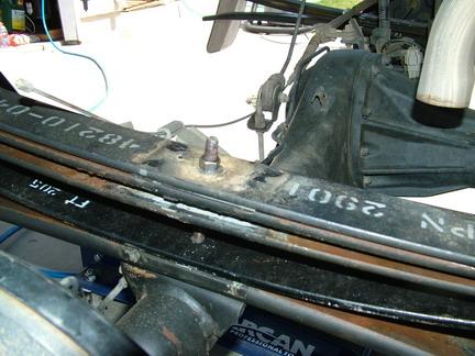

Here's a picture example
Notice how the bolt head is on the bottom, so you have to lift the springs off of the axle spring perch to get to that bolthead. That's lifting the truck pretty high off of the ground. and you'll certainly have to keep an eye on brake line overextension and driveshaft overextension.
Chevy leaves are exacly the same. I would assume Fords are too, but I have never disassembled them.
