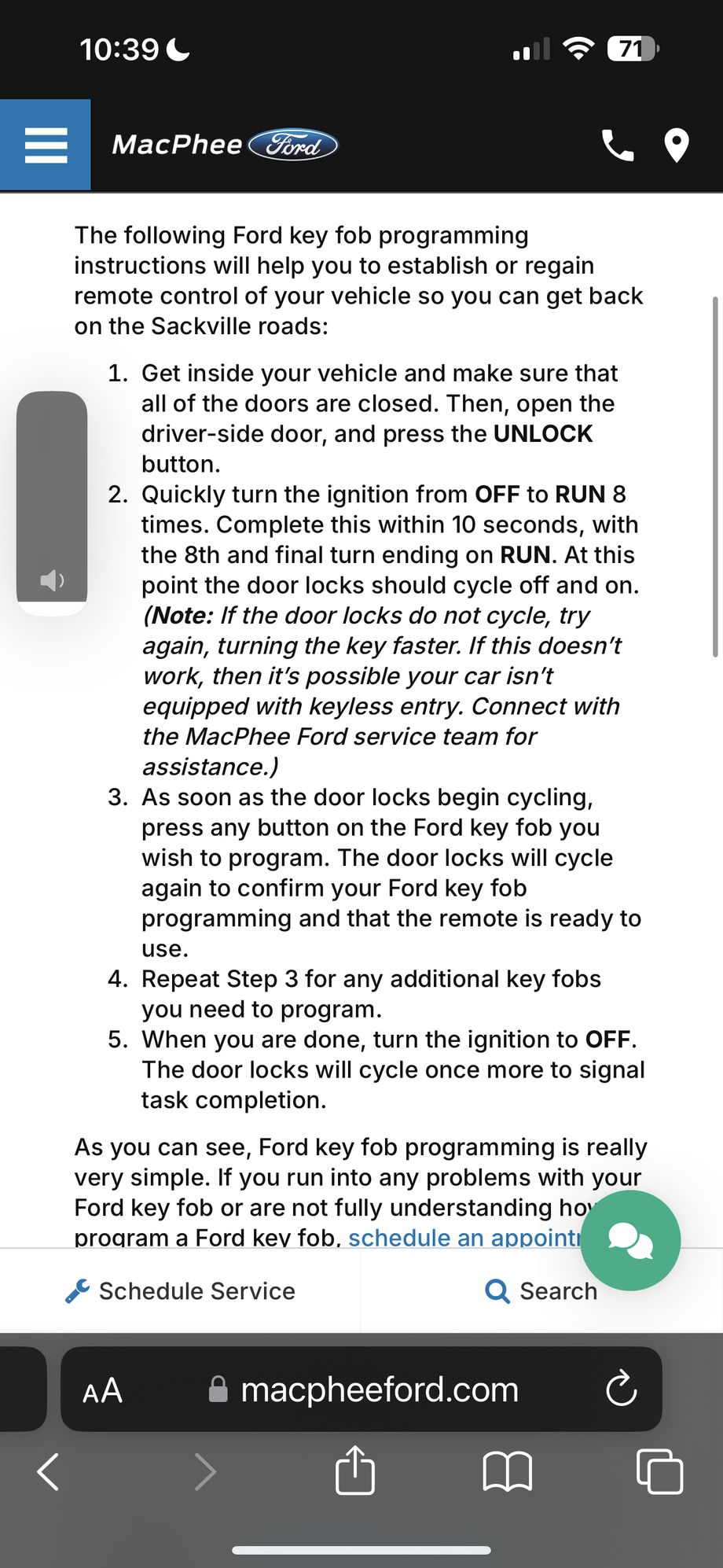

This is for Key Fob programming after cutting a key and programming the key chip.
It should present you with the factory door code.
