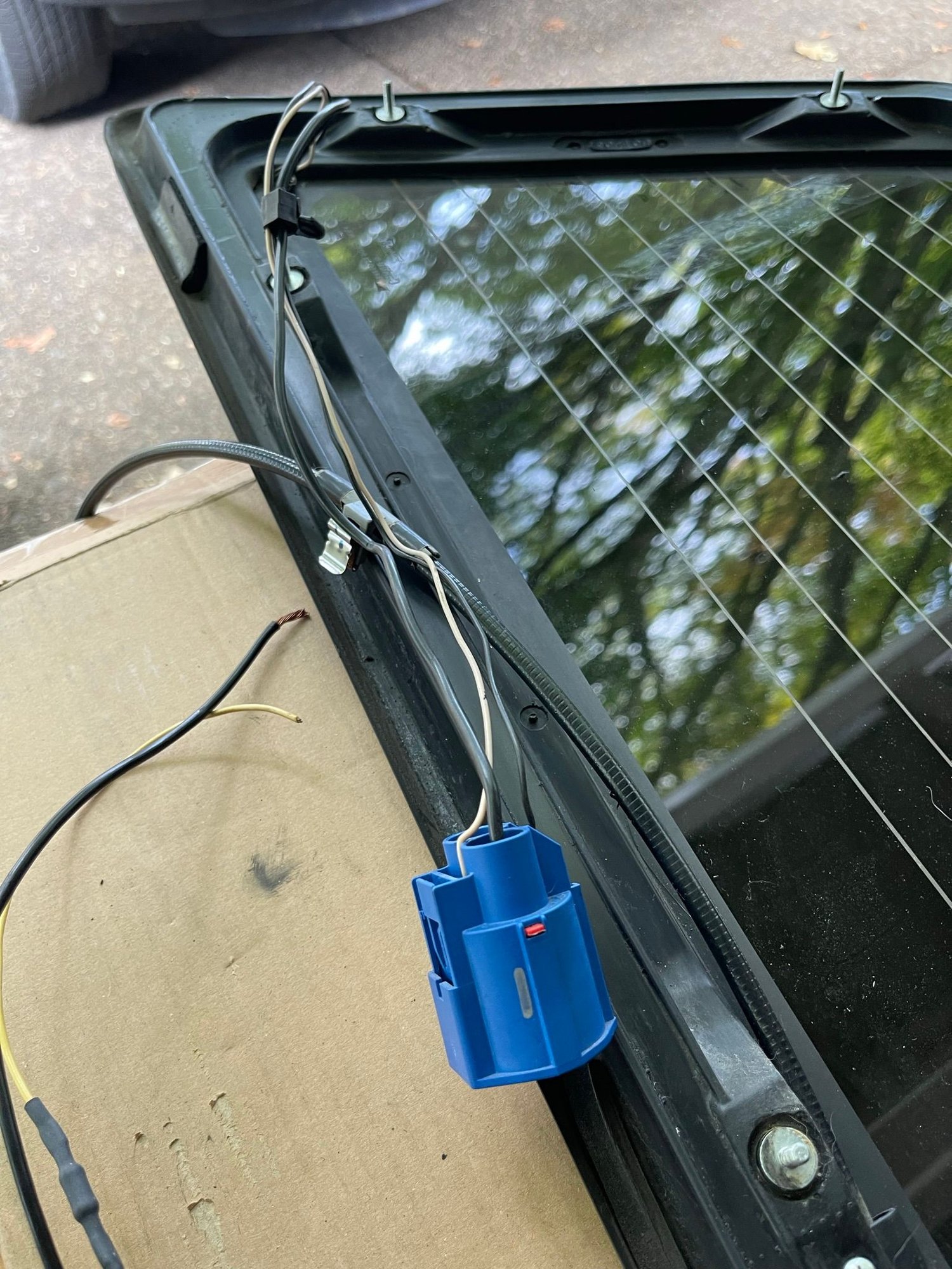

This is an old thread, reaching out in case anyone might know. I'm putting a 2010 rear
2012 connector
2010 connector
slider window into my 2012. The 2010 window has a blue connector with three wires (power + two others), my 2012 has two wires (power + yellow wire). From what I could find online, the second 2012 yellow wire is a 4V feedback to controller to show defrost is working, otherwise power is disabled. Does anyone know what the two wires are on the 2010 circuit? I've tried to research but haven't been able to find information on it
