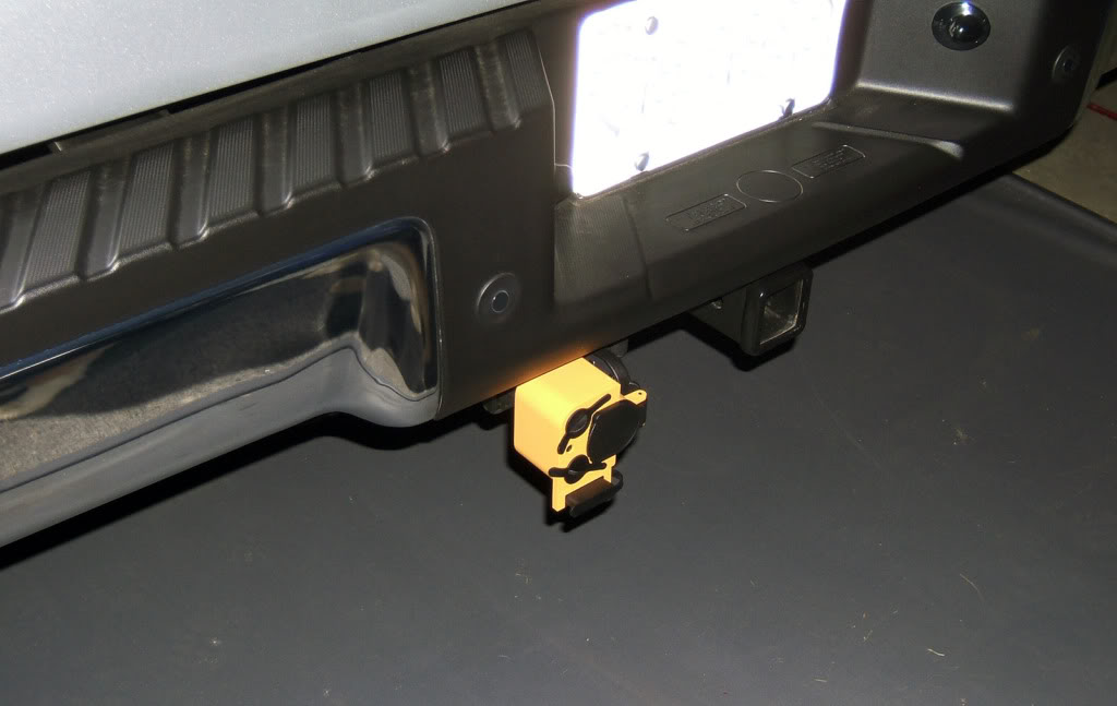

I was looking for something like this too for my Igloo thermoelectric cooler or the 12v Nomad Power Washer. Here's what I ended up with and a couple photos before and after painting (got mine from Amazon but Cabelas has lots of reviews).
Cabela's 7-way combo wiring adapter
