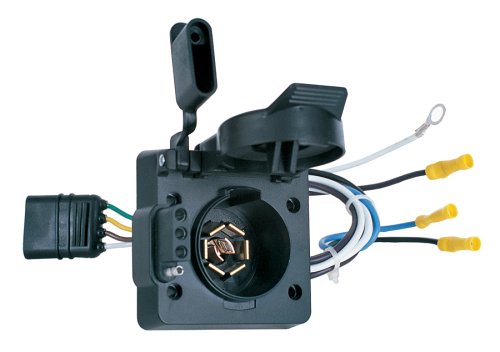

If Ford has a different main harness for non-tow package trucks you will have to wire in an aftermarket. It will have a T connection for stop, turn etc but you will have to run brake, battery and ground yourself.
I am not sure but this came up in a search.
http://www.hopkinstowingsolutions.co...t_1999-09.html
This is the universal way.
http://www.hopkinstowingsolutions.co...4_adapter.html
I don't know about the 09's, but the earlier trucks all had the same wiring harness whether it had the tow package or not - follow your 4 pin back, it should plug into a harness on the frame rail above the spare tire. There should be extra connectors back there for a 7 pin.
The harness should plug in with out a problem, Where you are going to run into the problem is the bracket to hold it on to the truck only comes on the hitch. I can send you the factory pictures if you like.. just email me at tascaparts@gmail.com
