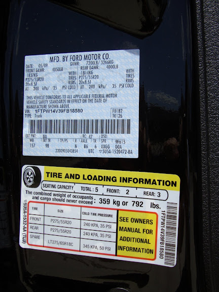

Originally Posted by 3kgtSL91
it says 792 lbs and it is a 6.5' bed
Is that a typo? Just 792 lbs?
How much do you think your trailer weighs fully loaded?
If its over 6000 lbs, you're probably over the payload rating for your truck (assuming just 10% on hitch = 600 lbs + 180 lbs for the driver = 780lbs).

unless we are talking about different things, but yeah i think that is it.
here i did snap a picture of the sticker:
i don't know much about towing but it is rated at 11100 lbs for towing so how can I be over that? I just don't know how all those figures work

The 11k pound "tow rating" is just about a lie for any Supercrew. At a minimum recommended tongue weight for bumper pull trailers of 10% of that 11k pound trailer, 1100 pounds puts you over your payload before you climb into the drivers seat. The 2009 Supercrew payload issue has been discussed at length here and over at another forum. It really is a shame Ford did not raise the GVWR on these trucks for 2009 when the weight went up by a few hundred pounds over similarly equipped 2008 models.
Payload is defined as GVWR minus everything that rests on the vehicle's suspension. So, the base truck, all fluids (7lb*36 gallons = 252 pounds alone!), passengers, any cargo in the truck bed, and any trailer hitch weight.
Not much you can do about things now because I doubt you want to trade in a $45k+ MSRP truck for a 3/4 ton truck. I highly recommend installing some air bags and replacing your tires with some that have a higher load rating.

Ford has really done everyone a disservice. VERY few people understand the payload and towing related figures that are posted on their web site. And dont think you can ask your sales person for help. I've not found, or heard of one, that understands either.
What you need to understand is that Ford advertises the maximum "potential" ratings for payload and towing. To get the max payload and towing, you essentially have to have a stripped down truck. Every feature / option on your truck lowers the payload rating, which in turn lowers your towing capacity.
The SuperCrew starts at something like 1780 lbs max payload. But when you subtract all the options on your truck, you're down to 792 lbs. Frankly, that's not enough carry 5 adults as passengers.

792? My 06 FX4 Screw is 1457. Is that 792 correct?

What is really weird is that the front and rear axle ratings are so high. Total axle is 8050. That isn't bad at all. I know the GVW is 7,200 but I'd weigh the truck and see what it actually sits at. I've never seen a F-150 with a 4050 front axle rating either, that is very high. I've only seen 3850. If that is the case i don't know if I want to trade my truck for that, my door sticker is 1600 something. that is scary.
