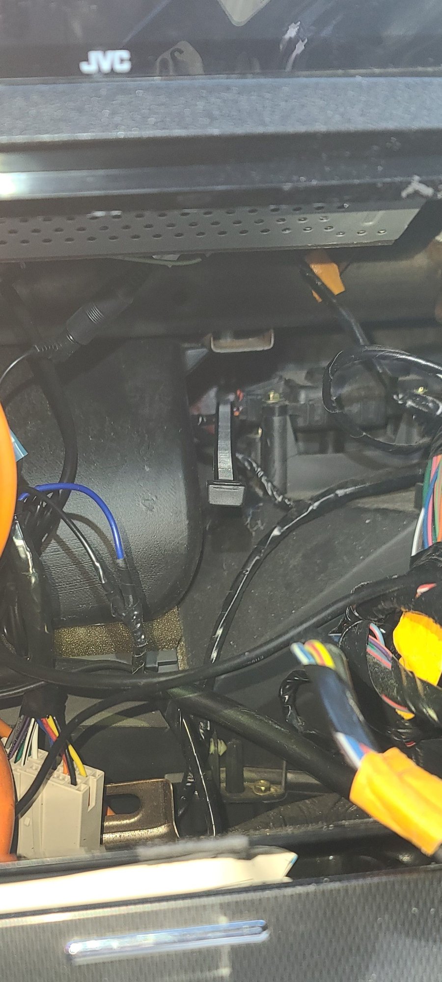

Now to the process. i popped the cener cover off and if you look just below the radio, you will see the grey firewall cover. There is only a few inches of firewall visible. This will be on the right side below the radio. After opening up the cover a bit you'll see the painted firewall. Drill there! You will need a long extension for your drill, like 20" or so. It's a pain to get the hole started but it's well worth the time My pictures show the location along with a long zip-tie thru the hole.

My only regret with these photos is that i used a black zip-tie, sorry.
You can see the zip-tie in the center going thru the new hole.
This is a shot of the area i was working in

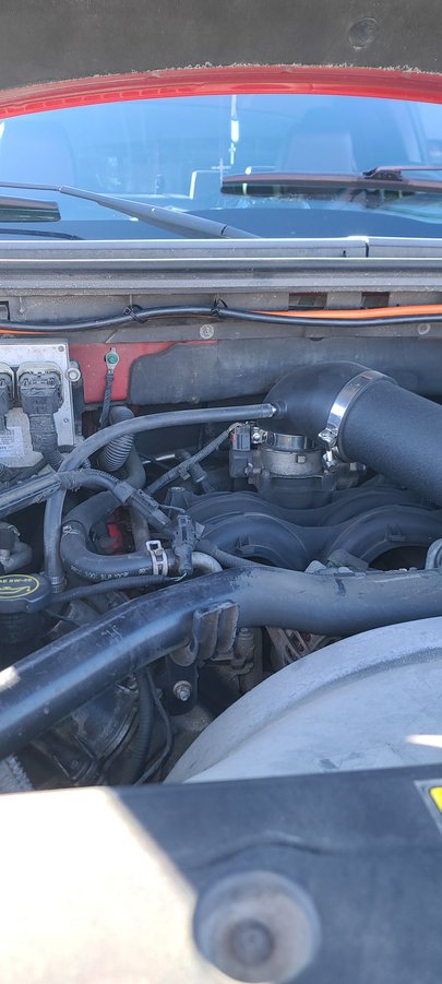

Closeup view in the engin bay with the zip-tie sticking thru the firewall.
This is the engin bay area where my wires will come thru. See the closer image to see the zip-tie.
