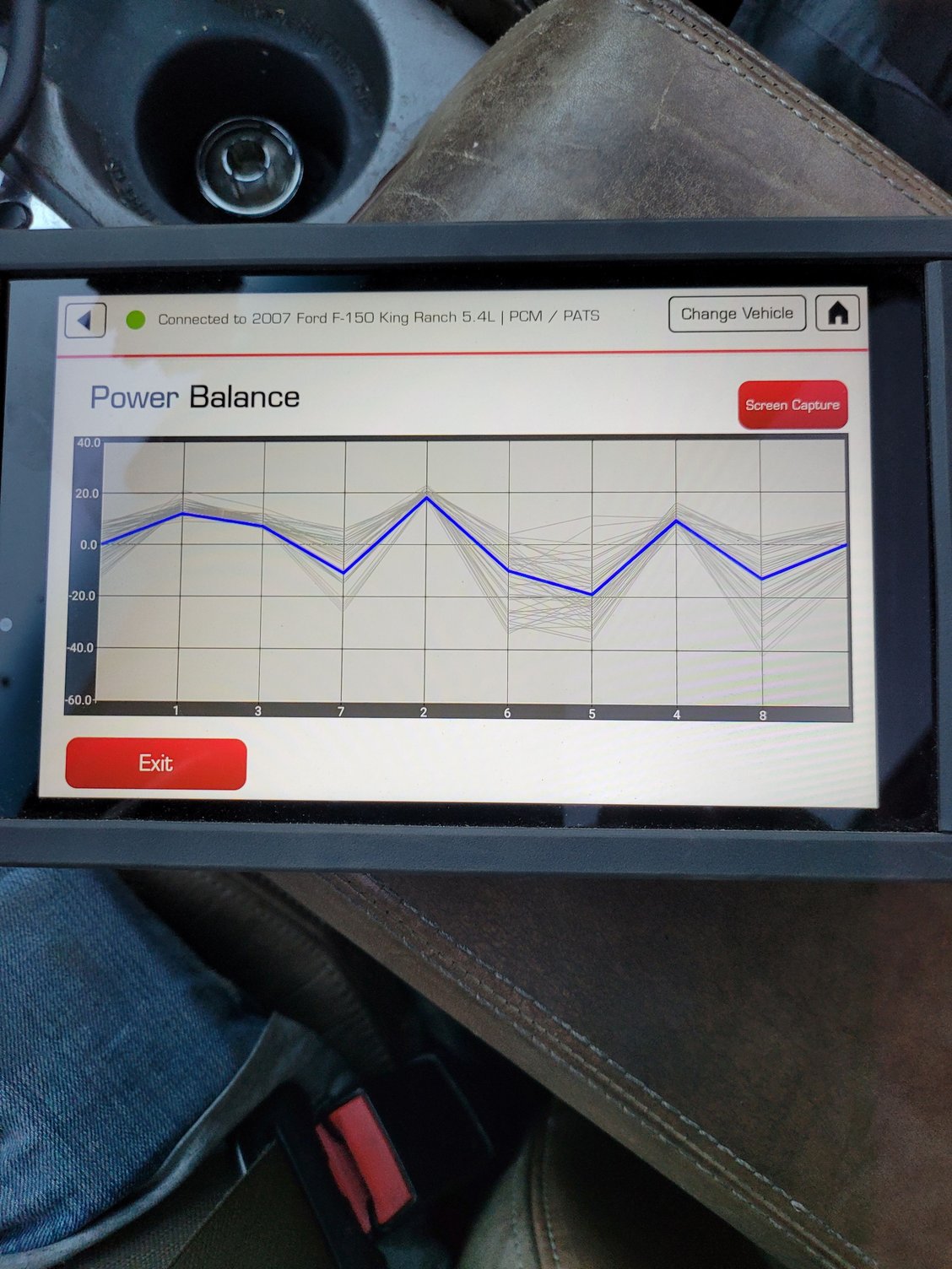

  • Spent weeks scouring online forums for directions.....TONS of great info but none could help me with bank 2 (all 4 cylinders) showing erratic firing but not logging codes. (see attached graph of Power Balance).

  • as you can see on graph I have 5 & 6 showing the worst in the balance graph....so removed injectors and swapped to 1 and 2 position. Same result....all 4 on bank 2 dropping out erratically.

  • One thing to note is that key on engine running when I pull plugs off any of bank 2 injectors, the power balance does not jump around like the picture shows, it actually drops off and stays low and steady. Plug back in and immediately the cylinder starts it's erratic pattern of firing as shown in the graph pic attached.

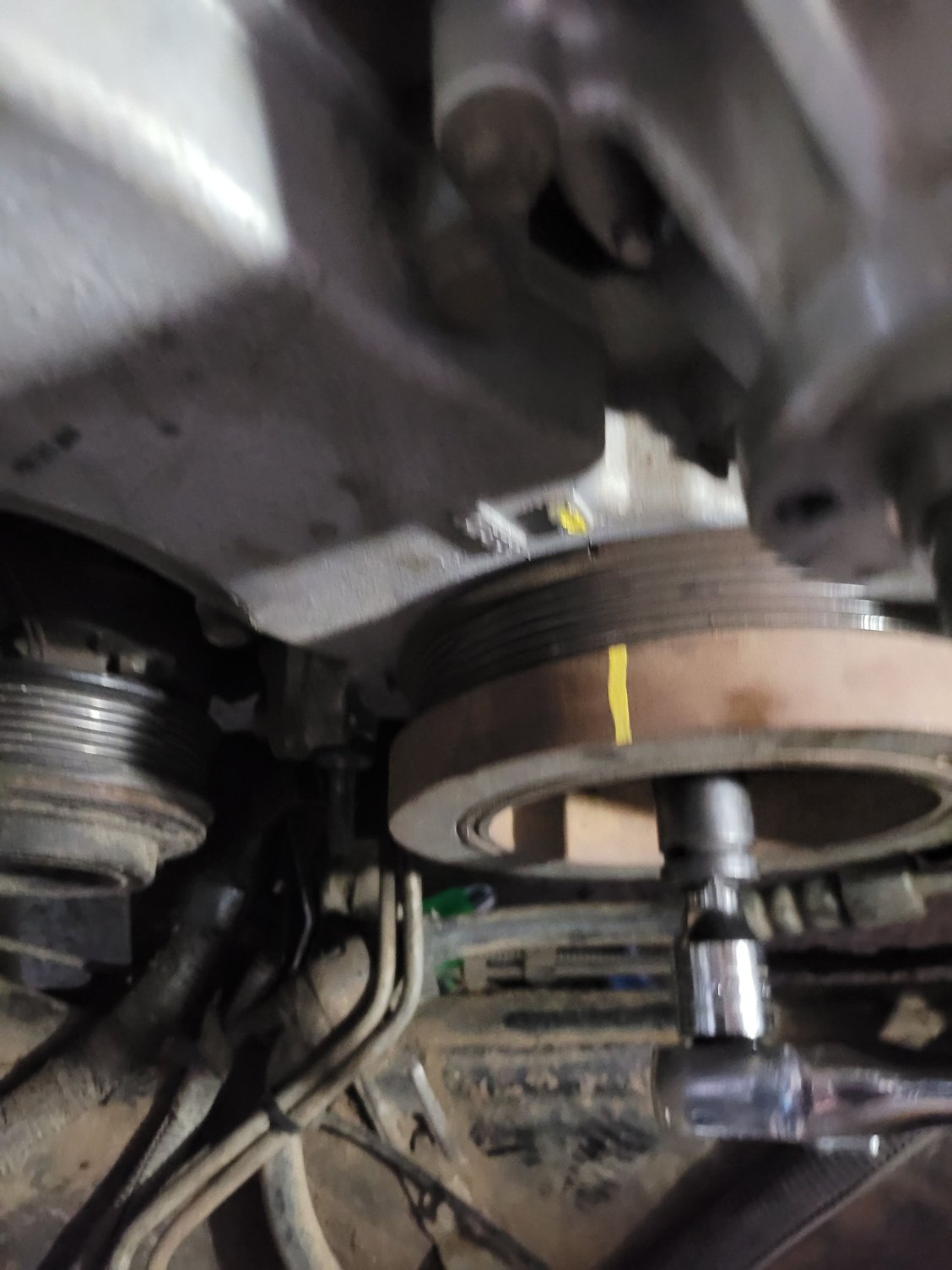

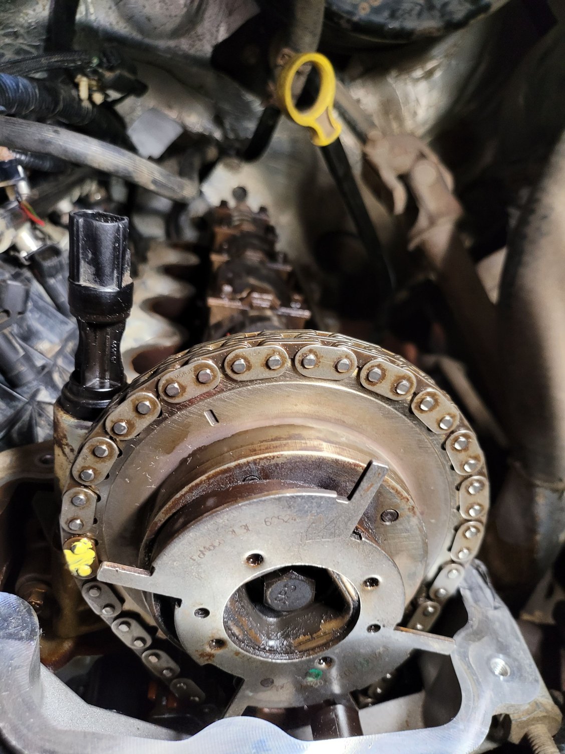

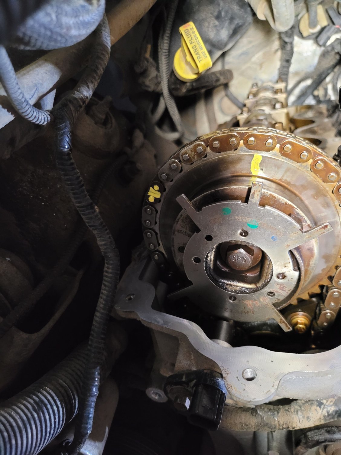

Stripped front end and removed valve covers. Found links on chain (which is not a great indicator but felt it necessary to guage any previous work before I got the truck). As you can see by pics...... Bank 1 cam is "close" to 12 o'clock and bank 2 is about 11 o'clock...... And crank is tdc on vibration damper. 1 revolution of crank switches sides with markings..... Bank 1 stays a wee past 12 o'clock but with the early Gen phazer markings (the dash) and bank 2 stays about 11 o'clock but with the indicator arrow....... Also to note the phazers looks to be holding true and have not let go as the middle finger of the tone ring is directly over the indicators on both gears...... So indeed it looks like a timing chain jumped a tooth or 2 on bank 2. Cover is coming off to assess guides and chains and other components as glc indicated. And yes previous workmanship indicates sloppy job as chains never line up with marks on cams (dark links marked yellow) which is only indicator of quality of workmanship prior to me digging in.
Bank 1 arrow just a lrch past 12
Bank 2 at about 11
Crank at tdc

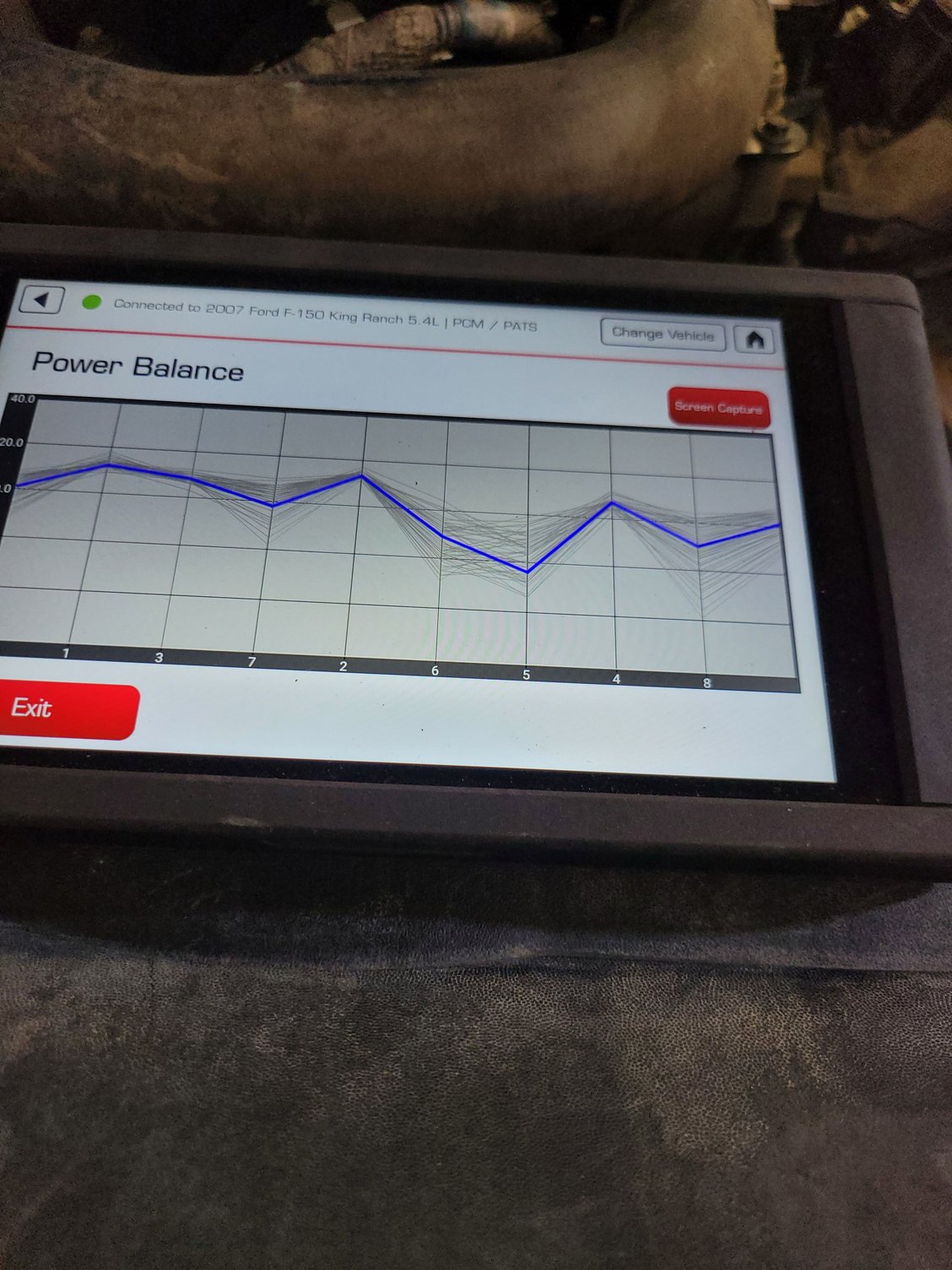

Ok.... Update 3.0......i have installed new phazers, guides, tensioners, chains and crank gear as well as the high pressure high volume oil pump and new solenoids and valves for camshafts. Primed pump and assembled engine and started up. I did find both phazers had broken pins that tension the springs so they only had the hooped end secured by the pins. I figured I had the smoking gun. Upon start up the bank 2 erratic misfires returned..... Or did not go away. The engine sounds like a brand new one and has never sounded so smooth mechanically. Top end is like a Swiss watch. The misfires on drivers side is going to be the death of me.
Just my hunch now but am leaning towards the PCM having a faulty driver's for the bank 2.
Any ideas more where to chase next?
