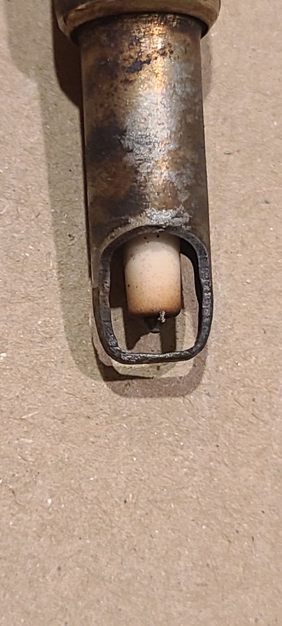

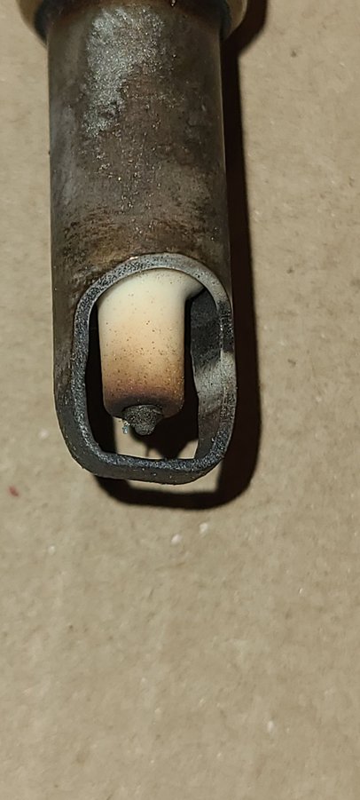

Hello. 2004 F150 5.4L the plugs I took out are longer Motocraft while the new ones are shorter. Both types are listed for the vehicle so not sure what the difference is. I mean I don't mind going with the shorter ones but wouldn't you want the spark to be occurring at the proper spot and both of them make that happen at different locations inside the cylinder head.
Also curious your thoughts on the removed plug if they look worn out if there's any kind of weird symptoms it looks pretty worn out to me.

That's curious that they would even sell me that at O'Reilly's if it's a three valve I'm glad you said something. I knew something was up with the different length. Now I'm curious about the coils. Not sure how accurate Amazon stuff is for a 2004 5.4. I know they're not the bent coils but I wonder what coils are actually the right ones then. This engine's got a hesitation when moderately accelerating and then I think it works through it I think it's probably a coil or maybe multiple ones but I just decided to go through and replace everything since I don't know the motor on this very well I've only had it 10,000 miles.
What do you think on the spark plugs I mean I seen some pretty ugly pictures these don't look that bad but they're pretty worn on the tips.

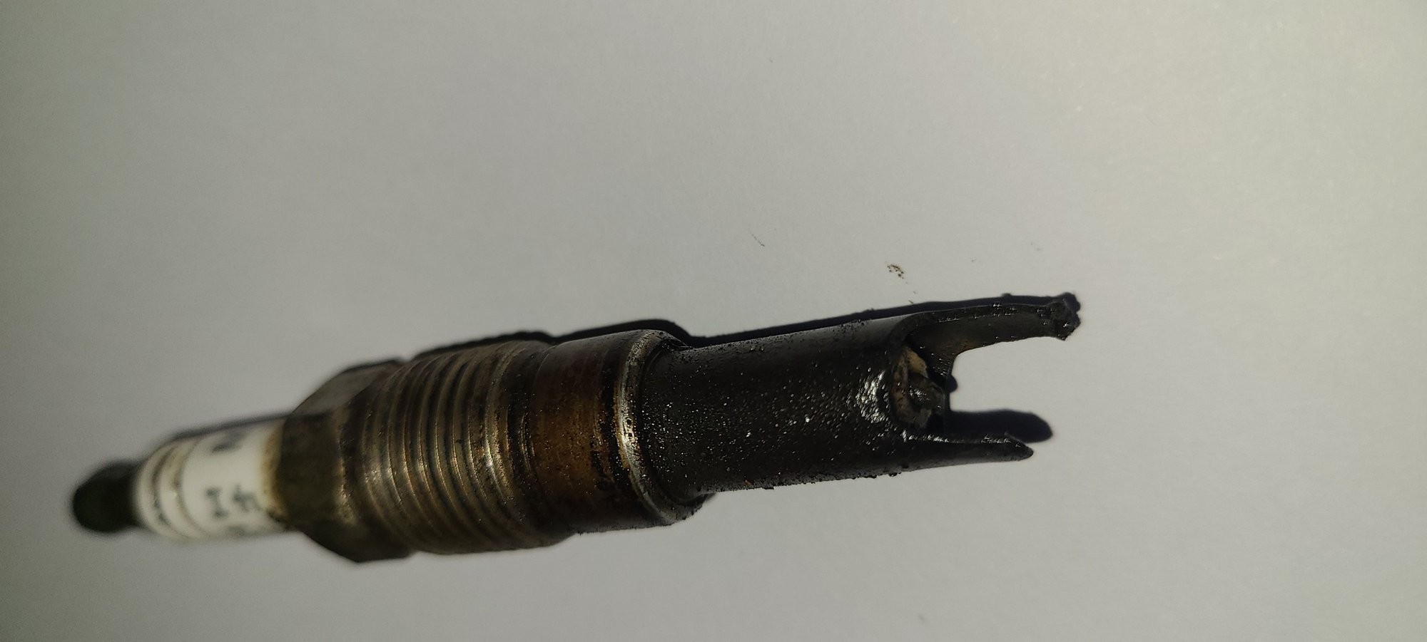

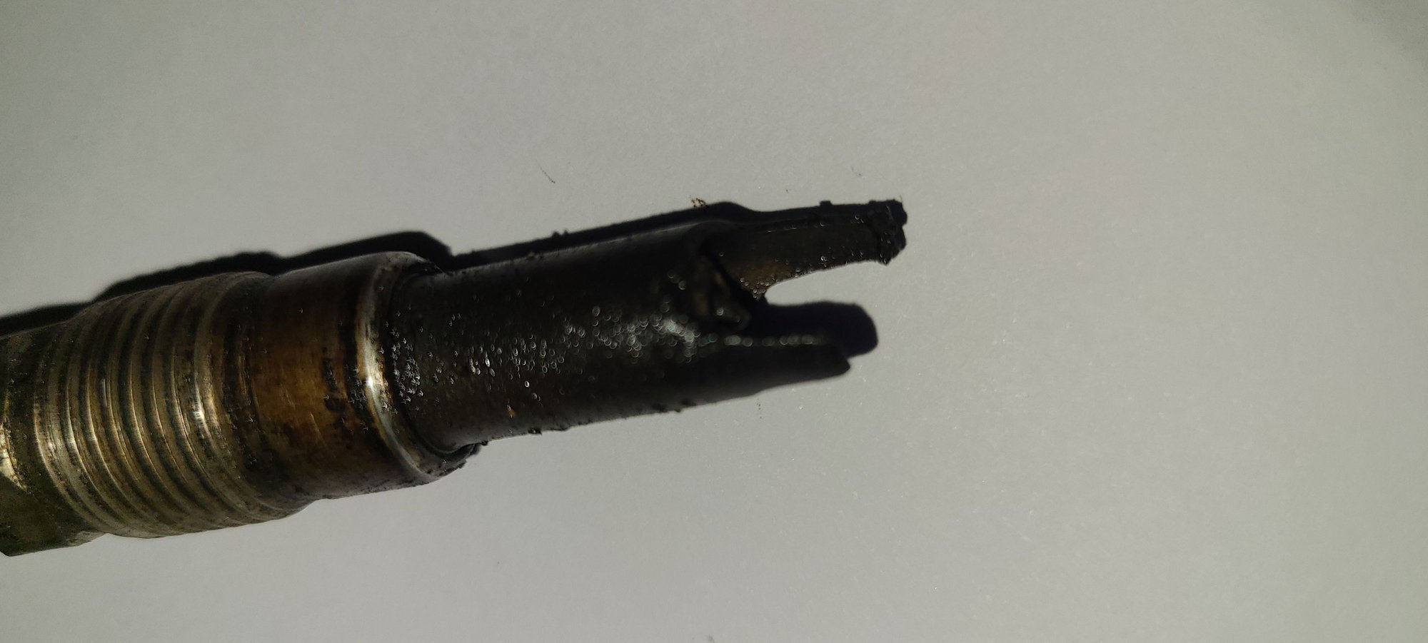

Well I was able to get all eight plugs out without one breaking. Six of the eight were the old style I think they're SP515s... Two were the new style SP546 and they had no damage and looked really clean. The other ones might have even been the original although there was some anti-seize on some of them so maybe some were replaced. I don't know who wouldn't just replace all the plugs especially knowing there was a new style and the old style was susceptible to problems.
To anybody wondering from what I can tell besides having an h instead of a k on the side of the spark plug like the third letter is an h the old style plugs are not welded at the bottom the little u-shaped end, where the new ones are perhaps this prevents them from breaking apart like the one I'm going to show you in the picture.
But with new coils and plugs the engine is so smooth it just idles so smooth and quiet! No more Miss and the mileage improved by about 25% from what I can tell so far with just about 40 miles on it since. Never threw a code that I could see with a $300 code reader but I'm sure the data would have told me which one had the bad plug. Pictured is the bad plug the bottom of its blown out and it appears luckily that it went out the exhaust or burned up.
I sprayed that penetrating hot stuff I can't remember the name of it in there and then I blew out each of the spark plug chambers with compressed air before removing them. Each one I put about 25% of my strength into it with the hand not the body or breaker bar. Only one I had to put a little extra on and it was the one in the very back on the driver's side. Once it broke they came out almost by hand with very few turns with a wrench so I guess I got pretty lucky.
See a picture of the spark plug that blew out.
