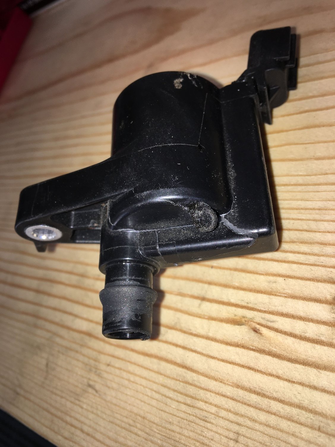

There’s a P0354 code for the #4 cylinder on a 2007 5.4L 3v, here is what is known and been done so far:
  • New plugs and COPs have been installed; all 8 cylinders
    • The COP on the #4 cylinder was cracked (see picture below)
  • Wire from the ECM to the COP of the bad/#4 cylinder; after new COP and plugs

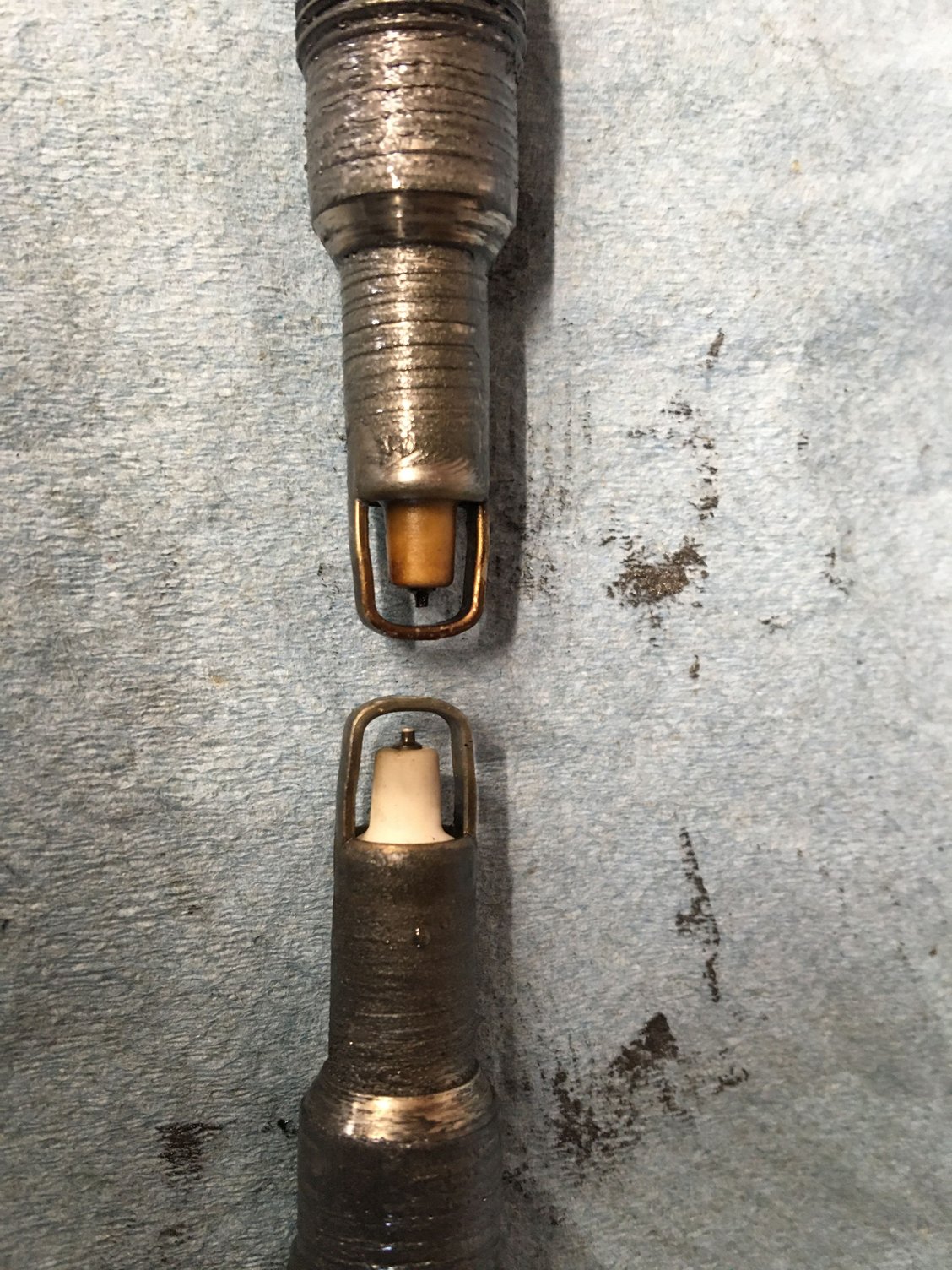

  • Swapped #4 and #2 COP and plugs.
    • Pics below; the #4 plug is the one with the dark ceramic at the tip - both have less than 100 miles on them.

yes the pcm can do that

Thanks. I found this, which given the CoP’s condition is what happened.
