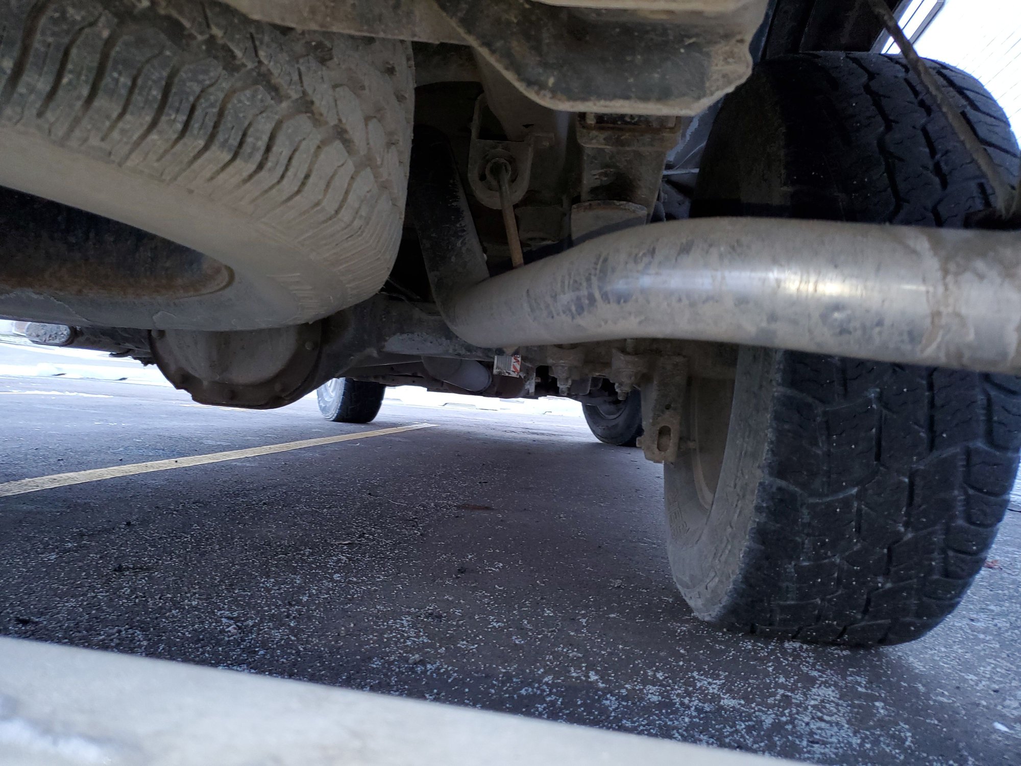

So while searching e-Bay and other sites for a cheap 3" tailpipe, I found an interesting discovery.
Walker 54890 is a 3" replacement factory tailpipe for a 2011-2019 F150 all engine sizes. It has a 2 3/4 inlet that could be trimmed off. The hanger is in the exact same spot as the original on this generation. Mandrel bent.
If you shop around, you can find it pretty cheap. I paid just over $40, with tax, to my door. Advance auto has them on their site. Just use the generic 25% off coupon.

I would say yes. If it fits the 04-08, and dimensionally they haven't changed the frames, it should fit the 09-10. I added some dirty pics to the first post.
