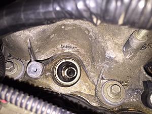

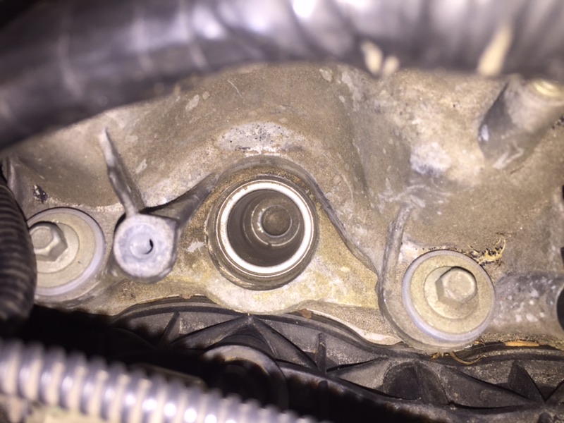

At 190,000 I’m doing my plugs for the second time. The drivers rear plug broke on me and the lisle tool won’t budge it after 3 days of trying with multiple tools (18 hours total with 3 people). There’s nothing left of the metal sleeve anymore for the lisle tool to grip,, I can see the crossbar on the broken plug so I know there’s nothing left in there. I did sacrifice my lisle tool and tightened it as much as possible with the strongest JB Weld I could find for one last try.
Looks like I’m gonna be pulling the head tomorrow so here is my question. Since this is an 04 screw Lariat, 5.4, what all should I do while I’m in there? I’ve had zero problems in 14 years...I’m so mad!

I can see i'm a little late in posting this for you ,but if there is any of the barrel left of the plug you could tap (tap/die kit) and re thread the barrel of the plug so the Lisle tool can get a bite on it..this is what i did...i tack welded a 3/8th tap on a long extension and put new threads in and it pulled right out with the lisle tool...

A deep well 9/16 and various straight extensions in 3/8ths and 1/2 inch got the job done. I repeated the process the exact same way this time, also following the numerous threads I e read on this site. So the truck was at operating temp, each plug was cracked loose, pb blaster in overnight and did the 1/2 turn out, 1/4 turn in procedure. Obviously this time it didn’t work.
I’m putting the Motorcraft SP 515s back in...time to put it all back together now! Thanks everyone.
Oh and once the heads were off all 3 stuck casings were so stuck it took a number of chisels and many hammers to get them out...the pics are deceiving, the plugs don’t look that bad to me!
