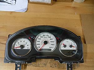

For the past couple of weeks my cluster will randomly turn off/reset it self.
The cluster will turn off (tac, speedo, gas gauge, battery gauge, etc) and also the radio, interior lights, power windows/locks.
Then all the warning lights and chimes will come on at the same time and stay light up (4x4, abs, engine, parking brake, etc)... like it would when you open the key all the way before turning the truck on.
Tac, speedo, and all my gauges twitch when they turn off, and when they come back on they return to the adequate position.
I cleaned both the NEG and POS terminals/cables of the battery and that seemed to help a little bit. Everything doesn't turn off every 10 seconds now, but it still happens.
I would like to note that I hear a "click" noise coming from the fuse box (I think that's where it's coming from) when everything turns off. Maybe its a fuse or relay that overheats.
My truck has the following cluster style...
Attached Thumbnails Cluster Will Randomly Shut Off While Driving-666_500_csupload_57357169.jpg
