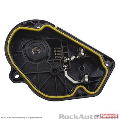

This is my first post and I've looked everywhere to try and find it, but I can't find where the throttle position sensor is on my 2006 with the 4.2 any help is greatly appreciated

It looks like this:
It should be on the side of the throttle body.

Thank you for that, guy at the parts store sold me something totally different and I had no clue.
I have another question about the sensor. My truck will almost stall out and when coming to a stop and while just coasting. I've change the spark plugs and wires, Fuel filter, and cleaned off the air filter. Could this sensor have something to do with that?
