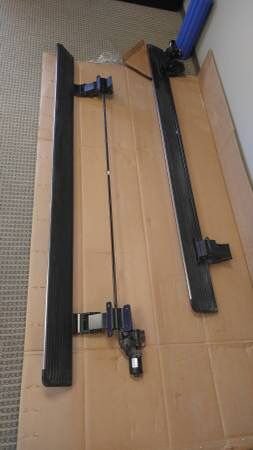

Anyone know if the power steps from the '16 King Ranch F150 will fit on an '06 F150? I have an opportunity to buy a set pretty cheap but I'm wondering if they will even fit...
King Ranch steps are 85" long
I'm sure the plugs can be spliced easily
Would I need to get any other pieces for them to work? Relays or anything?
Here's some pics of the brackets/plugs:

I'd look at AmpResearch website and compare part numbers. They make the factory boards for all the brands that have power boards GM, Ford, Land Rover etc
Look at kits for 2016 vs 2005 part numbers
While you're there see if you can get the harness separately for your 2005
