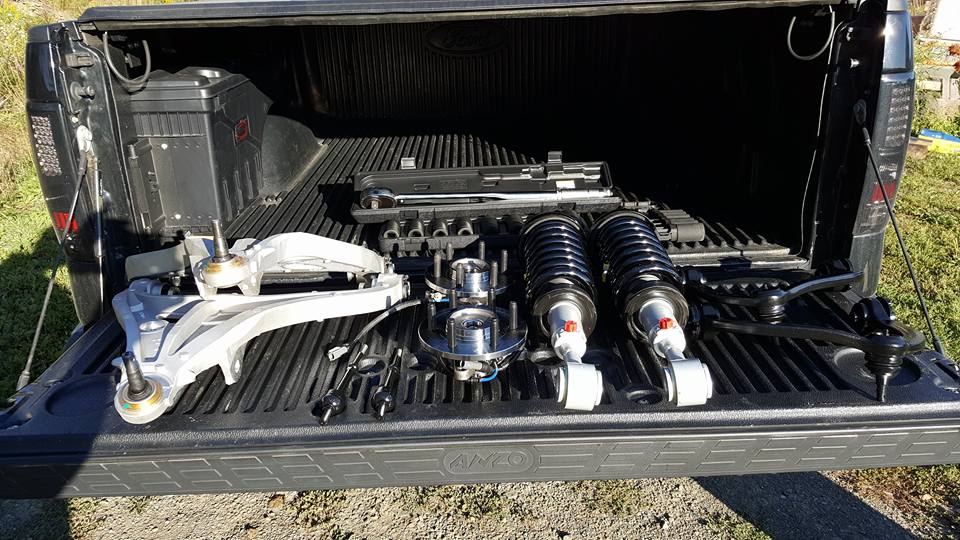

I just did Rancho quick lifts, and this is what I replaced:

Replace absolutely everything you are willing/afford to. IF you intend to keep your truck for sometime. If you are going to pay for an alignment might as well change out every part that is prone to long term vulnerability. My truck drove great after moog ball joints ( upper/lower ), control arm bushings, sway bar endlinks. I replaced drivers side wheel bearing only due to cost, and a year later I had a loose tie rod end. So I replaced both outers and inners, and paid for another alignment when I could have prevented the problem in the first place with everything apart.
Very good! Even got fresh control arm bushings since you bought the whole units. Well done.
Yeah, I had just done inner and outer tie rods the week before, all Moog except the struts. I could have easily rebuilt the LCA's, but choose to replace them due to time constraints. What a difference a fresh front end makes! It's super tight now and doesn't feel 'lazy' anymore.
